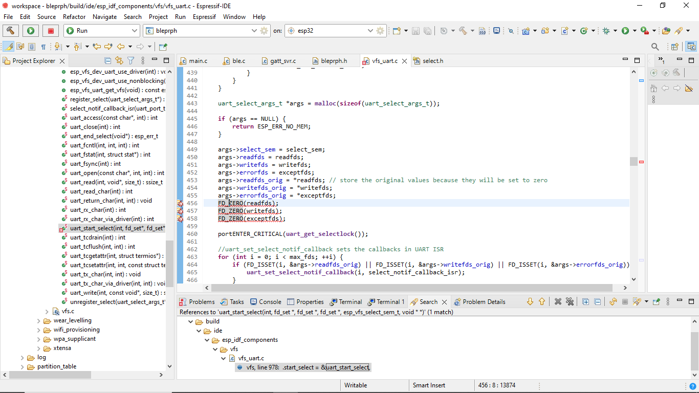

i saw it in build file. symbol _n couldnot resolved.
Screenshot (87).png (136.5 KiB) Viewed 4693 times

You would certainly get more and better help if you could start to show code that is in any way relevant to your problem.

is this the problem?
Screenshot (88).png (108.75 KiB) Viewed 4546 times
