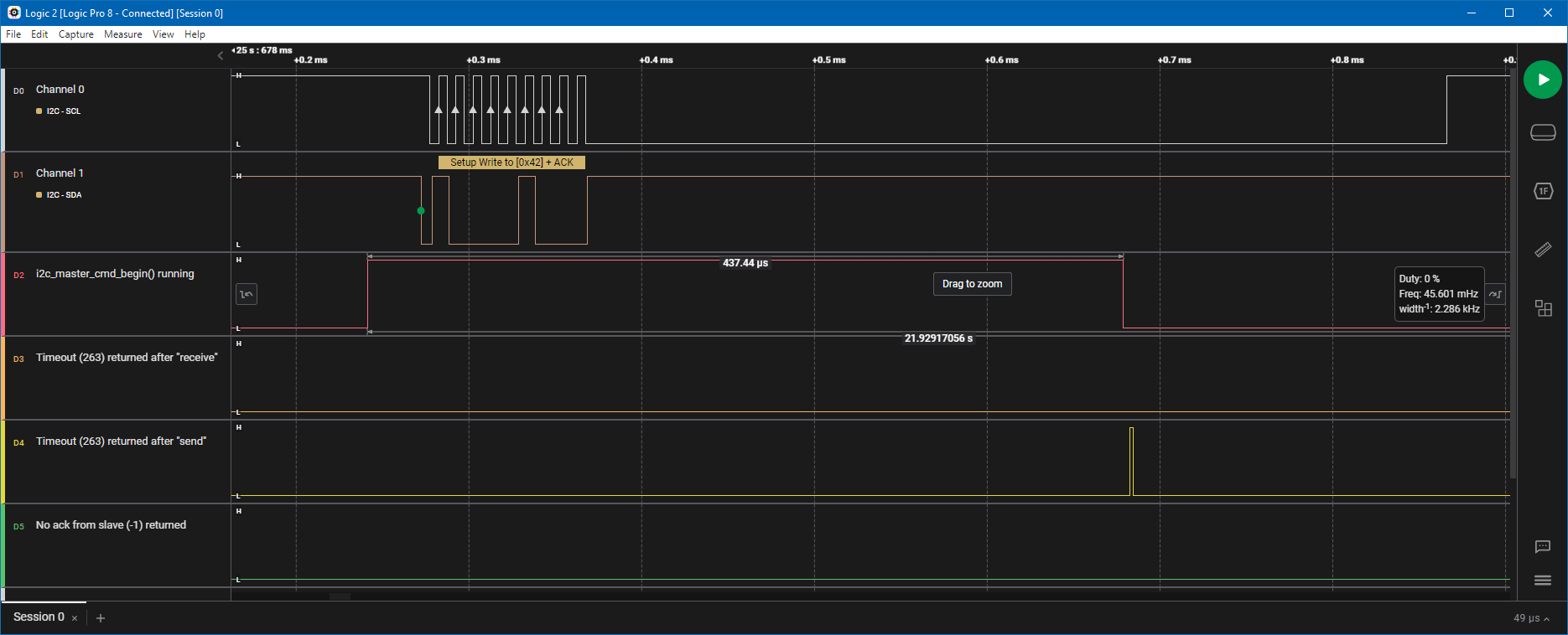

I have now run my tests on an ESP32-S3 Devkit board and the outcome is the same as it is on our own HW. Probing the I2C bus, it seems as though the ESP32-S3 is simply choosing not to continue clocking the bus.
Here is a complete Saleae trace of the entire test suite that we run (about 6 minutes), which passes perfectly with ESP32, where the red line indicates that i2c_master_cmd_begin() is running, the blips on the orange and yellow lines indicate that a timeout error has been returned by i2c_master_cmd_begin() (orange for when the ESP32-S3 is doing a "send" to the device, yellow when the ESP32-S3 is doing a "receive" from the device) and a blip on the green line indicates that "no ack from device" has been returned by i2c_master_cmd_begin():
Zooming in on the first error, an error on send:
...you can see that a write has been set up to address 0x42 and the device has acked it (at least as far as the Saleae probe can tell) but then there is no clocking for the rest of the write, which I guess results in the timeout. All of the timeout errors on send, the yellow blips, look like this.

For the benefit of anyone who gets here, after a few days of conversation with an _extremely_ helpful and knowledgeable Espressif engineer, we figured out what was going on, details here: https://github.com/espressif/esp-idf/issues/11397 but in summary the value passed to `i2c_set_timeout()` in ESP32 is a multiplier on the 80 MHz APB clock but on the ESP32S3 it is NO LONGER THAT SIMPLE, the value is instead a power of two times either the XTAL (40 MHz) or, if you have selected it, the RC network (17.5 MHz) clock period. So:
ESP32S3: timeout = 2^x * (1/40000000)
...which is how they can get away with having a 5-bit timeout register. The technical reference manual and ESP-IDF documentation don't really make this switcheroo clear, be warned!
We set a timeout of 10 ms because the GNSS device we're talking to over I2C can be very busy, especially as it is booting; I thought the I2C timeout worked the same as ESP32, which in 5 bits means a max value of 0.38 microseconds, so I was just leaving it set to the default as I thought it was of no practical use; the default value of 12 works out to 2^12 * (1/40000000) = 102 microseconds, which is not quite enough when talking to a very busy GNSS device. Now that I understand what's going on I can in can set it to 19 instead of 12 to get the desired effect; my instability goes away.
