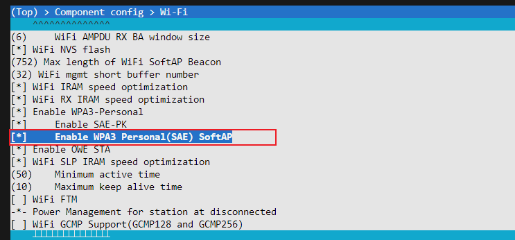

Hi Team!
I tried to Configure WPA3 in Access Point Mode as well as Station Mode using esp-idf v5.0.2.
Two types of tests I did, one is
(1) In Station Mode, I can able to configure WPA3 and successfully established a connection over WPA3 configurations and also options are there in menuconfig to enable WPA3 in Station Mode.
another one is, Access point
(2) And I enabled WPA3 in Access Point mode through menu config.(It was shown in the attached image)
But I can't able to establish a connection over WPA3.
My doubt is
(1) How can I Establish a WPA3 connection in Access point Mode in esp32s2?
(2) How to enable 4 way hand shaking in ESP32S2 AP Mode?
(3) "Enable SAE-PK" and "Enable WPA3 Personal (SAE) SoftAP" is not shown in my menuconfig. In which version of ESP-IDF, It will be there?
Someone Please help me. It's very needful for me.
Thanks in advance.
Regards
Brindha K

Re: ESP32S2 WIFI AP MODE 4-WAY HANDSHAKING
hi,kumar, sorry for late reply, the WPA3 soft AP mode is a new feature on 5.1, you can try the version later than 5.1
Hi
I used "esp-idf v5.1-rc2" download link https://dl.espressif.com/github_assets/ ... .1-rc2.zip
and setup tools version "esp-idf-tools-setup-offline-5.0.2" download link https://dl.espressif.com/dl/esp-idf/
I didn't get AP configurations like yours. Please refer the previous attachment that was running idf v5.1-rc2 but I didn't get SAE configurations.
Please help me to get SoftAP WPA3 configurations.
Regards
Brindha K
Regards
Brindha K
hi, Kumar, as the zip might be upload in earlier, so I suggested that you can use git command " git pull " and " git submodule update --init --recursive " to update to the latest version.
