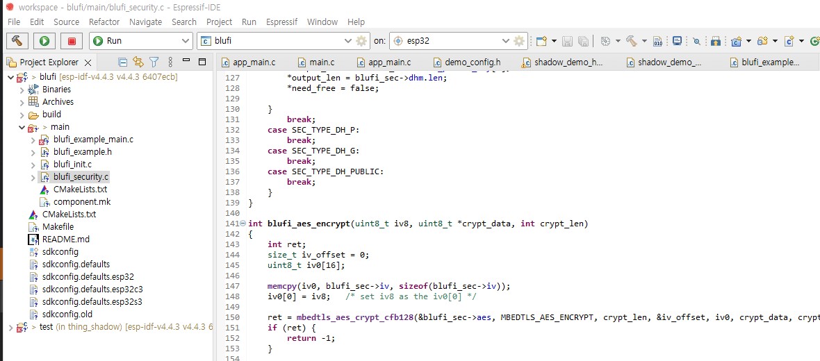

I started to develop with ESP-Module two months ago.
I have some many problems,,,I want to resolve below First Problems!!!
I have esp32-s3-wroom-1 Board.
I install espressif-ide(espressif-ide-setup-2.7.0-with-esp-idf-4.4.3) on the my windows PC.
I make the project at available idf templates.
I succeed to compile the project.
But i don't know how to download the project image to esp32-s3-wroom-1.
please tell me that!!!!!!!!!!!!
Please Someone tell me how to download my image from ESP-IDE to my test board.

Two step process:
1. Configure serial port
2. Click on `Launch` button (second button from the left on the toolbar)
I hope that helps.
