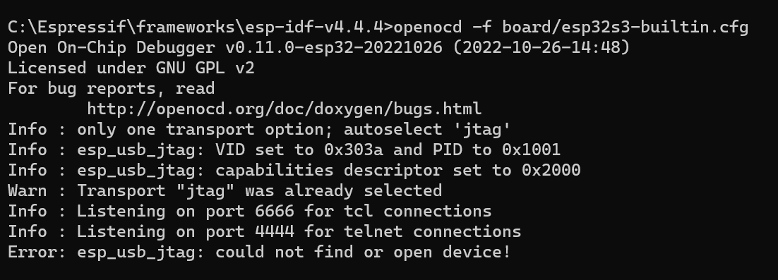

I'm trying to debug the Korvo-2 V3 board but I'm getting the below error error

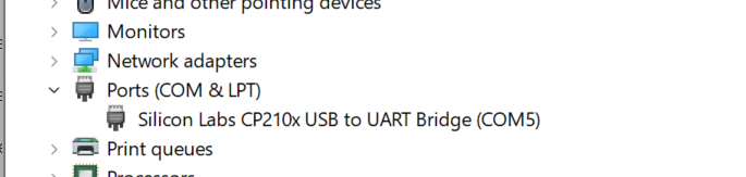

also when I checked the device manager I saw the driver
Screenshot 2023-07-03 234306.png (38.54 KiB) Viewed 1903 times
so why Am I getting this error "Error: esp_usb_jtag: could not find or open device!"
I know that it maby be an issue with the driver but I don't know how to be fixed!
Please advise!

By default, that board uses an external USB-serial chip to interface with the S3, which does not support JTAG debugging. It has the capability to switch to the internal USB interface, but it requires reworking the board; specifically the 0 ohm jumper resistors R181/R182 need to be moved to the R394/R395 positions.

Thank you very much, It is working!
