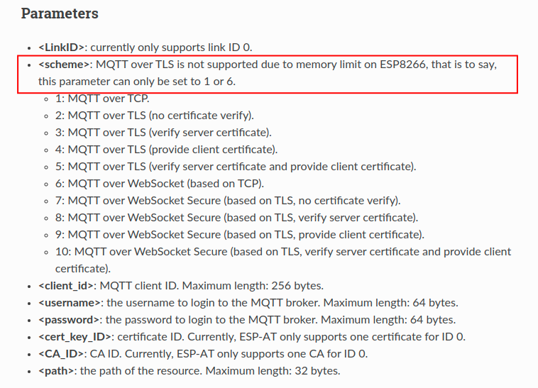

I'm using the ESP8266 (WROOM-02D) for MQTT over WIFI. I'm using AT commands for MQTT. I'm currently using ESP8266-IDF-AT_V2.2.1.0 firmware on the WROOM-02D. My broker has been configured to use both client and server certificates for authentication.

Whenever I execute the command
AT+MQTTCONN
, the module will reset. The module will reset even if use the default provided certicates. I found that the module will reset whenever MQTT scheme uses TLS (with or without certificates).
When I set the scheme to 0 (TCP and no TLS), there is no issue.
I've tried several things and even different firmwares but cannot get it to work.
When looking at the AT command manual, the MQTT user configuration has a "path" parameter.
AT+MQTTUSERCFG=<LinkID>,<scheme>,<"client_id">,<"username">,<"password">,<cert_key_ID>,<CA_ID>,<"path">
I'm not sure if this could be the problem, but I cannot find any documentation on specifying the path.

hello, you are right. ESP8266-AT does not support MQTT over TLS due to memory limit.
And the doc described here: https://docs.espressif.com/projects/esp ... parameters, please know.

Wouldn't it be a low-cost feature to simply report an error instead of crashing?

Sorry for the inconvenience. For a well-designed firmware, it shouldn't crash anyhow. However, memory issues are a global problem, and if any component does not handle memory allocation properly, it can lead to crash situations. As the ESP8266 SDK will not undergo significant updates, it is unlikely that the current behavior will be changed.
If you wish to use MQTT over TLS, we recommend considering ESP32-C3/ESP32-C2/ESP32 chips as a priority.
