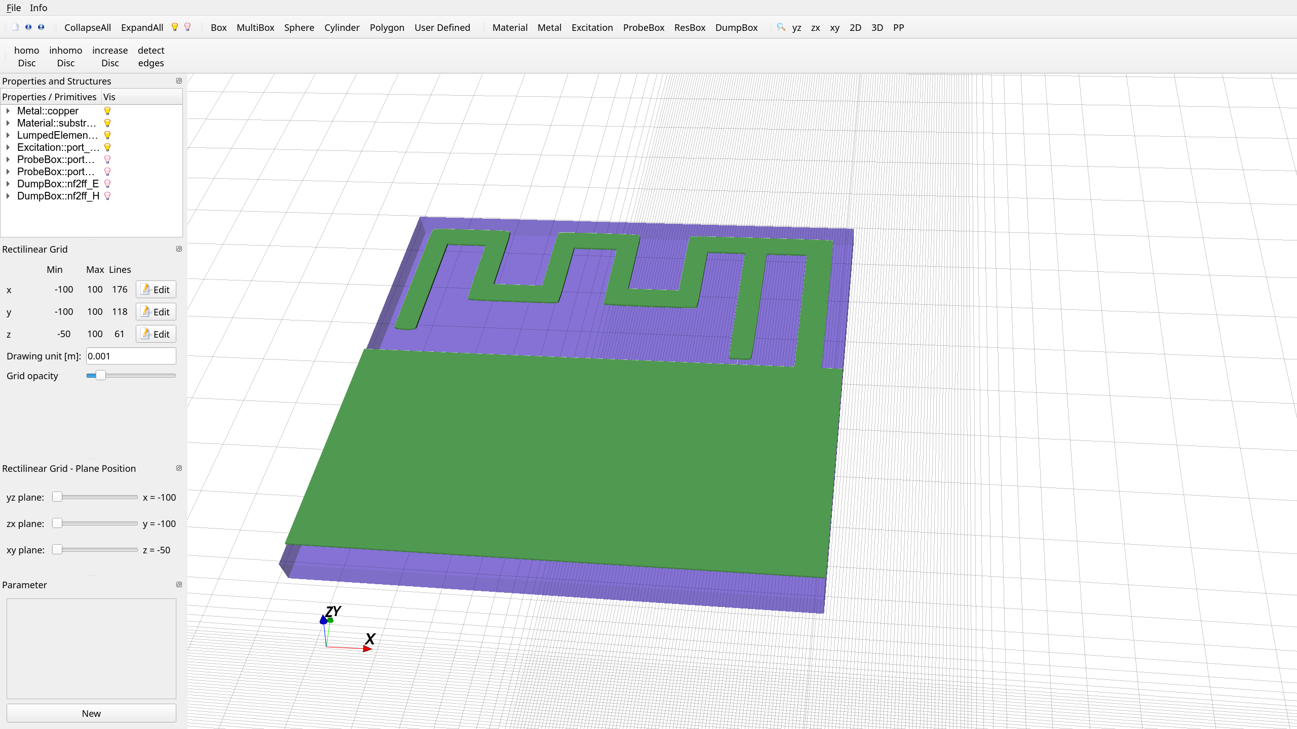

As a reference, here's our mPIFA antenna as seen on the WROOM modules.

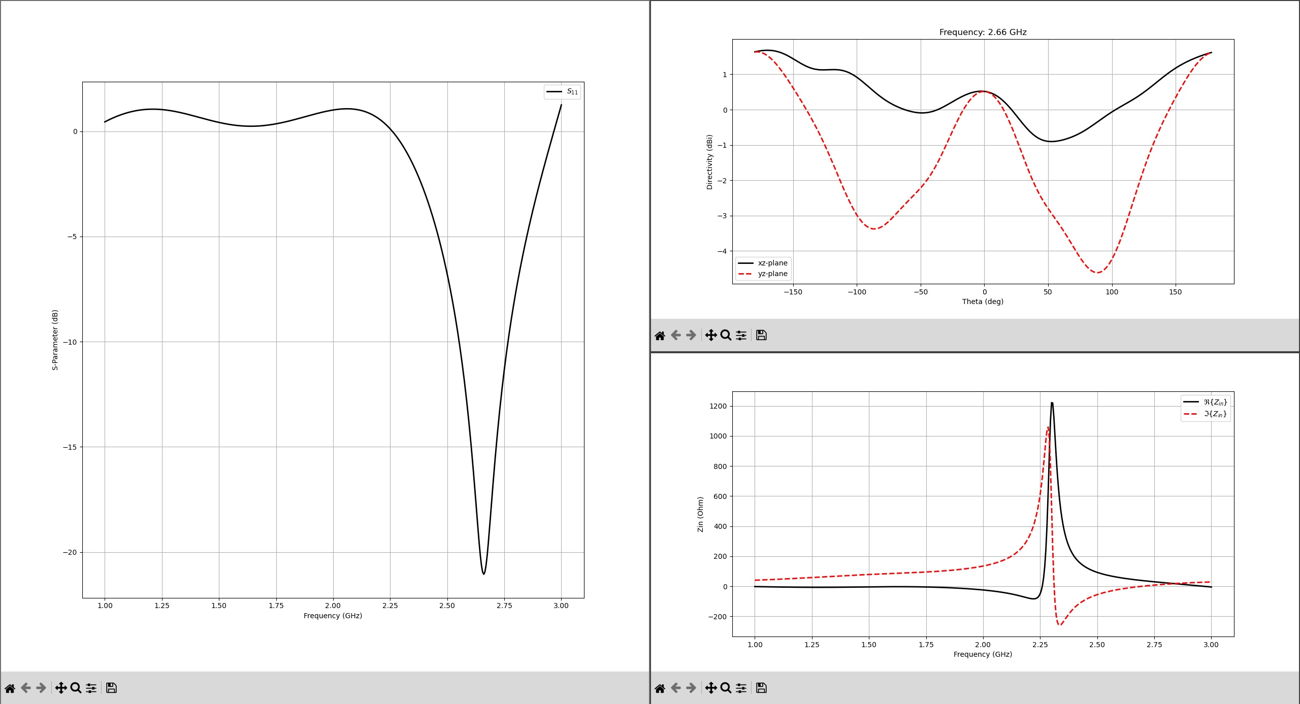

I needed to convert the ever-loving shit out of the thing (Gerber -> PDF -> Inkscape SVG -> png -> Inkscape SVG -> Freecad -> STL -> OpenEMS) to get it to import in OpenEMS, and I think some error creeped in the scaling, as seen in the results:
Of major interest is the large S11 graph on the right. As described here, the S11 ratio is the amount of signal *NOT* radiated by the antenna. If this is very low at your target frequency, you have a good antenna. In this case, there's a really nice low -20dB minimum around 2.7GHz. This should be at 2.4GHz obviously, but as I said it's likely the antenna got scaled down somewhere along the line, increasing its frequency.

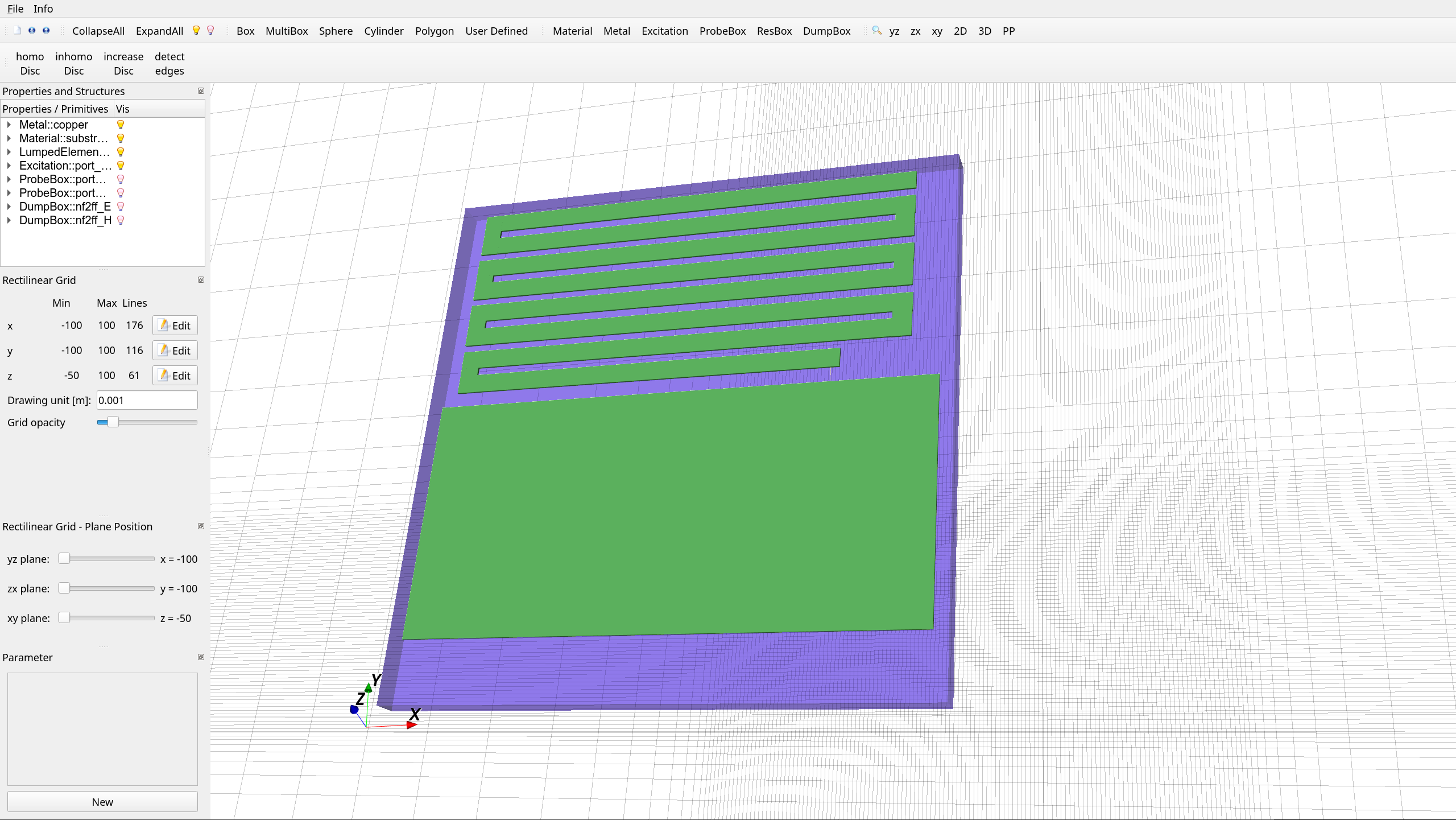

Now your antenna design. As your specs aren't much more than 'meander a line for about 12CM', that is what I did. I took a fairly random trace width, trying to keep your drawing in mind but also the size it occupies on a module. For the substrate, I use the same 0.8mm FR4 as I did for the mPIFA.

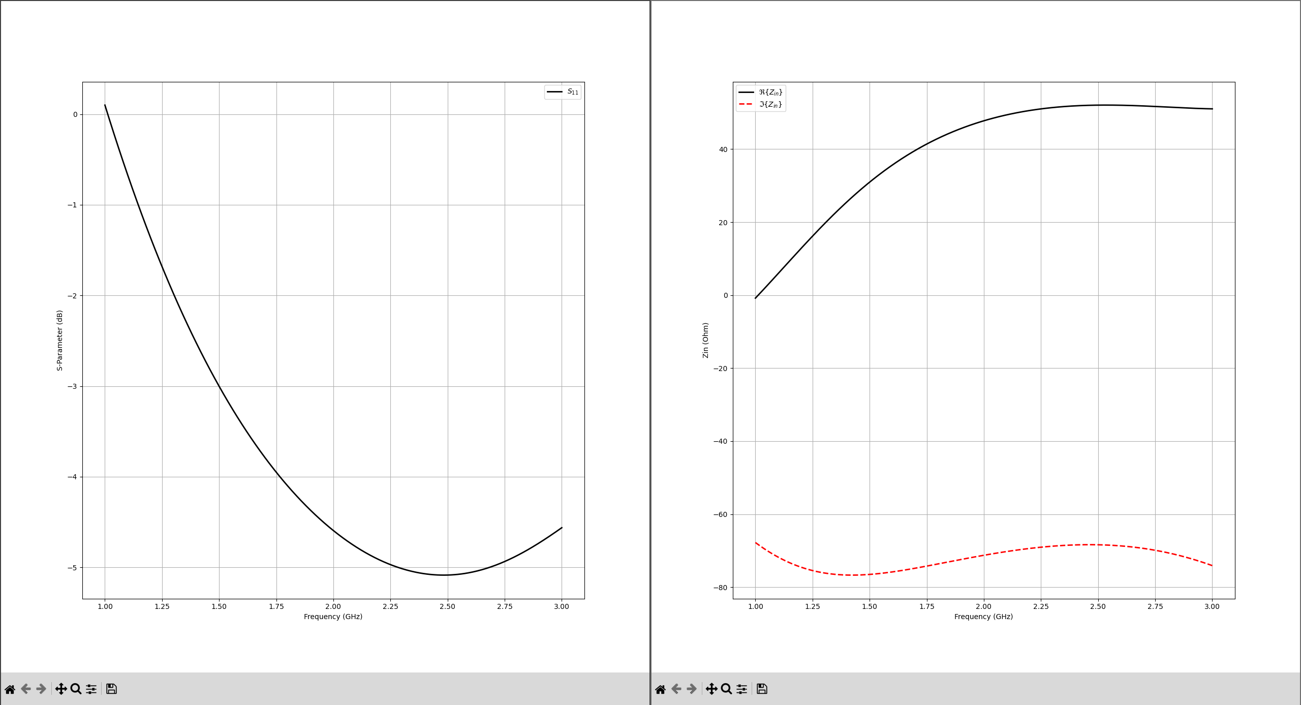

And here's the result:
Note the antenna does actually work: there's a minimum nicely around 2.4GHz in the S11-graph. Unfortunately, this is only at -5dB, meaning that for WiFi, this antenna will emit about 32x less energy than the mPIFA we use right now (ignoring the scaling error in the previous simulation, in other words assuming the actual minimum is at 2.4GHz).
All in all, it looks like the 'meandered whip' you made is actually functional, but it has a very low Q-factor; it trades a high gain for a high bandwidth. Unfortunately, that is not very efficient for WiFi which uses a narrow range around 2.4GHz and doesn't need the rest of the band where this thing works well. If this were for e.g. an UWB signal, it would be the other way around: the mPIFA would not be ideal as it has a narrow bandwitdh and your meandered whip would work a lot better. (But also note that UWB modules tend not to use either of these designs: they likely use something that given the bandwidth they do need has the highest gain possible.)

Postby svenbieg » Sun Jul 23, 2023 4:42 pm
Thank's a lot! I gave it a try, and the result of my antenna looks much the same as Your current design:
The S11-graph on the left has a positive share, looks like the negative half sinus.
Both graphs on the right side have a higher scale. Unfortunately i don't hit the 2.4GHz, maybe i have to play around with the length.
Looks like my graphical solution from high-school isn't that bad, You just forgot to put the end of the antenna to a maximum distance.

Postby Sprite » Mon Jul 24, 2023 1:49 am
That is interesting. I took the feedpoint more-or-less from the existing PIFA I modified. Didn't imagine there would be such a difference in performance, honestly. Do note, however, that you demonstrated at best parity with the PIFA rather than superiority, but I didn't expect that to be possible either, I'll admit.
One thing I do have to note is that your antenna is a lot more directional, with minimums of -7.5dB in the far field; the PIFA only drops to -4.5dB. That means the orientation vs the access point matters a fair bit. This is around the 90 degree angle, though, which means that the dual-antenna setup (the 'T-shirt ESP32 module' design) would compensate for this. It does matter for a single antenna though.
Another thing is that my hacked-together design seemingly is not perfect; the literature suggests that a 'real' PIFA should get an extra 4dB or so if tuned properly. As I said, I don't really want to invest more time simulating as I've got better things to do, so I'm not gonna try to eke out that extra 4dB in the sim.
