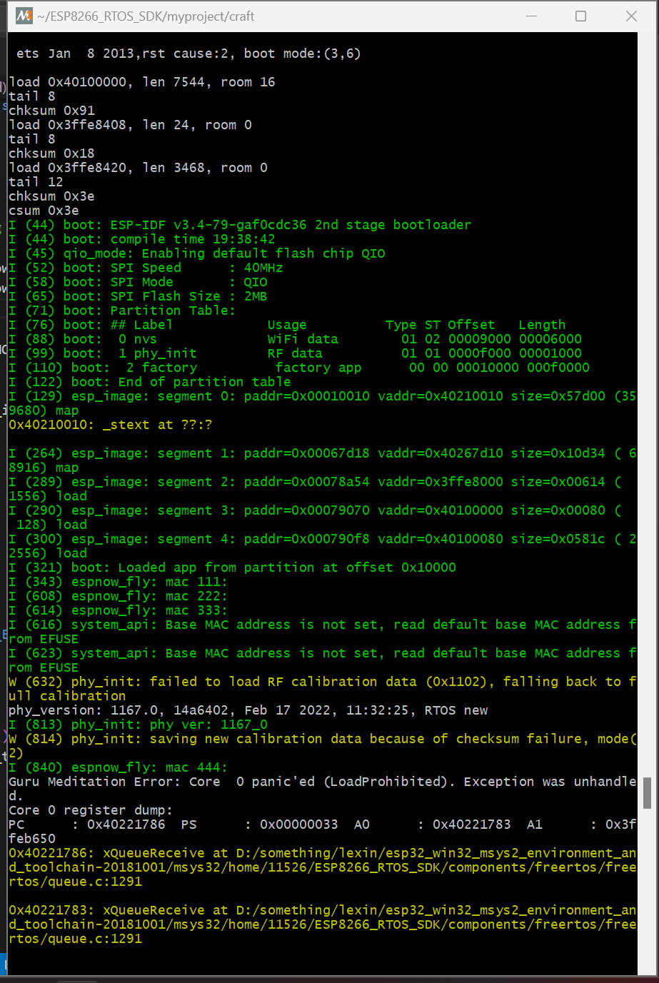

esp8266,WROOM-02D做的板子,烧录程序出现错误,无限重启,已经穷尽办法,走投无路了。麻烦大家帮忙看看怎么解决,谢谢!
相关信息请看附件!
相关信息请看附件!

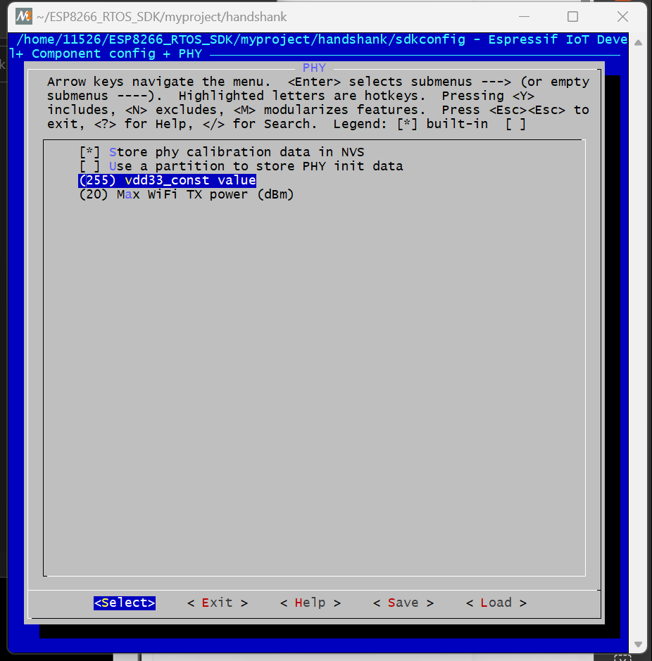

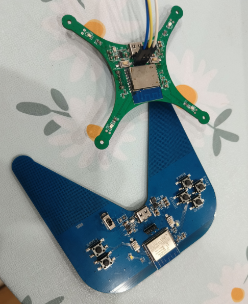

最近又配套做了个手柄,手柄ADC采集VDD的,vdd33_const设置为255了,并且TOUT脚悬空了的。但是烧录程序后还是一直说要我设置成255,并且一直重启,麻烦大神看看,这是咋回事?

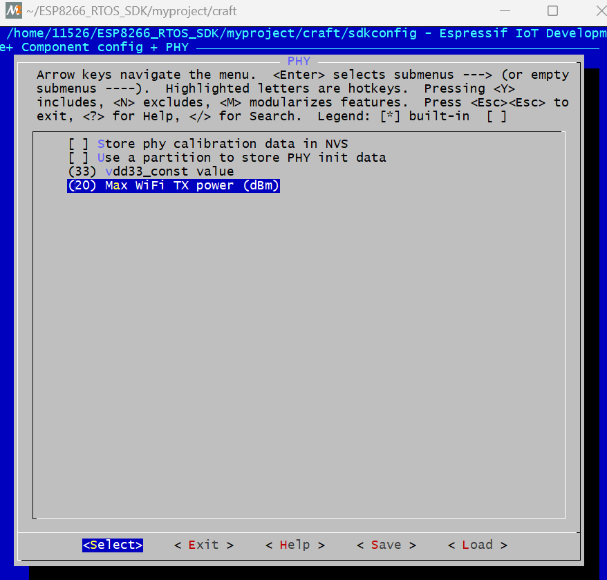

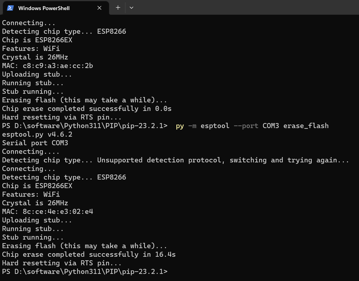

Re: ESP8266无限重启
您好,我已经按照您说的擦除了FLASH和不配置Stote phy calibration data in NVS,但是问题依旧存在,还是不断重启,程序未变,详细log如下:

Hash of data verified.
Compressed 3072 bytes to 83...
Wrote 3072 bytes (83 compressed) at 0x00008000 in 0.0 seconds (effective 1637.1 kbit/s)...
Leaving...
Hard resetting via RTS pin...
MONITOR
--- idf_monitor on COM3 74880 ---
ets Jan 8 2013,rst cause:2, boot mode:(3,6)
load 0x40100000, len 7544, room 16
tail 8
chksum 0x91
load 0x3ffe8408, len 24, room 0
tail 8
chksum 0x18
load 0x3ffe8420, len 3468, room 0
tail 12
chksum 0x3e
csum 0x3e
I (44) boot: ESP-IDF v3.4-79-gaf0cdc36 2nd stage bootloader
I (44) boot: compile time 19:38:42
I (44) qio_mode: Enabling default flash chip QIO
I (52) boot: SPI Speed : 40MHz
I (58) boot: SPI Mode : QIO
I (65) boot: SPI Flash Size : 2MB
I (71) boot: Partition Table:
I (76) boot: ## Label Usage Type ST Offset Length
I (87) boot: 0 nvs WiFi data 01 02 00009000 00006000
I (99) boot: 1 phy_init RF data 01 01 0000f000 00001000
I (110) boot: 2 factory factory app 00 00 00010000 000f0000
I (122) boot: End of partition table
I (129) esp_image: segment 0: paddr=0x00010010 vaddr=0x40210010 size=0x57a60 (35
9008) map
0x40210010: _stext at ??:?
I (264) esp_image: segment 1: paddr=0x00067a78 vaddr=0x40267a70 size=0x10cd4 ( 6
8820) map
I (288) esp_image: segment 2: paddr=0x00078754 vaddr=0x3ffe8000 size=0x00614 (
1556) load
I (289) esp_image: segment 3: paddr=0x00078d70 vaddr=0x40100000 size=0x00080 (
128) load
I (300) esp_image: segment 4: paddr=0x00078df8 vaddr=0x40100080 size=0x0581c ( 2
2556) load
I (320) boot: Loaded app from partition at offset 0x10000
I (344) espnow_fly: adc read: 760
I (346) gpio: GPIO[2]| InputEn: 0| OutputEn: 1| OpenDrain: 0| Pullup: 0| Pulldow
n: 0| Intr:0
I (351) gpio: GPIO[5]| InputEn: 0| OutputEn: 1| OpenDrain: 0| Pullup: 0| Pulldow
n: 0| Intr:0
I (364) gpio: GPIO[13]| InputEn: 0| OutputEn: 1| OpenDrain: 0| Pullup: 0| Pulldo
wn: 0| Intr:0
I (378) gpio: GPIO[16]| InputEn: 0| OutputEn: 1| OpenDrain: 0| Pullup: 0| Pulldo
wn: 0| Intr:0
I (392) gpio: GPIO[4]| InputEn: 0| OutputEn: 1| OpenDrain: 0| Pullup: 0| Pulldow
n: 0| Intr:0
I (406) gpio: GPIO[12]| InputEn: 0| OutputEn: 1| OpenDrain: 0| Pullup: 0| Pulldo
wn: 0| Intr:0
I (421) gpio: GPIO[14]| InputEn: 0| OutputEn: 1| OpenDrain: 0| Pullup: 0| Pulldo
wn: 0| Intr:0
I (435) gpio: GPIO[15]| InputEn: 0| OutputEn: 1| OpenDrain: 0| Pullup: 0| Pulldo
wn: 0| Intr:0
I (449) pwm: --- PWM v3.4
I (455) espnow_fly: cnt: 0
I (461) system_api: Base MAC address is not set, read default base MAC address f
rom EFUSE
I (475) system_api: Base MAC address is not set, read default base MAC address f
rom EFUSE
W (488) phy_init: failed to load RF calibration data (0x1102), falling back to f
ull calibration
I (554) espnow_fly: cnt: 1
phy_version: 1167.0, 14a6402, Feb 17 2022, 11:32:25, RTOS new
I (667) phy_init: phy ver: 1167_0
W (670) phy_init: saving new calibration data because of checksum failure, mode(
2)
I (1345) espnow_fly: adc read: 697
I (1445) espnow_fly: cnt: 2
Guru Meditation Error: Core 0 panic'ed (InstrFetchProhibited). Exception was un
handled.
Core 0 register dump:
PC : 0x00000000 PS : 0x00000030 A0 : 0x00000000 A1 : 0x3f
fee020
A2 : 0x00000020 A3 : 0x00000000 A4 : 0x40105e68 A5 : 0x3f
fecc50
A6 : 0xffffffff A7 : 0x00000072 A8 : 0x00000000 A9 : 0x00
000000
A10 : 0x00000000 A11 : 0x00000000 A12 : 0x00000000 A13 : 0x00
000000
A14 : 0x00000000 A15 : 0x00000000 SAR : 0x00000000 EXCCAUSE: 0x00
000014
Backtrace: 0x0:0x3ffee020
-n M\% %^║ Q
╔ E
5 ╗ ╝ )d E 5^╔ NRA
K
T Ɇ ) @ Y
r
T╝ RR e@ VU ╔ ^
NRA╝ JJkN 9 N V -C q║)
╚B 5 K'nآҡ - n║ V I Q C J @ Y
╔ OV1OV U +
A A
1m + RAˀn \║ I
Yؓ ╔ rD╔ T ║ 7ԅ ╔╔+aE EA JC
%Y╔╚@)╔╔╔3mʃ
%Y╔╚
% X7 V%G C B @ [
╔ \1. uE C JA ╔%[
╔ C T╔╔╔╔╔╔ ҍ
╔╔╔╔1 7╝[݊P╔Q
+)YГ ╔ `FB [
╔-Z╔╔╔╔╔╔╔ IP NP╔╔╔
%Y╔1cOK
╔╔╔╔5╝HL ╔╔╔╔
D╔G╝╔
Y
╔%. P╔╔╔╔%. XP╔╔╔ G╝Y A JCB- q║)Q [
Y
7 ʋ 1NT G )YГ
X ╔ \╔ 9] ╝ ) +
G J G@J n ╔ Y 1 9#= 9E 7 ╝%G ╔e═
+ ʃ
L@J C 7 V1 95T ═9 ═╔ m╝X ╔╔ME╔Y ʃ
G J D@H 7 V P]╝=═9E ╔ m╝╝ ╔ )CH +
E╔ VZ)C#P% V1 Ls
#║T݊P1 +
)R}║ED
I (345) espnow_fly: adc read: 760
I (348) gpio: GPIO[2]| InputEn: 0| OutputEn: 1| OpenDrain: 0| Pullup: 0| Pulldow
n: 0| Intr:0
I (353) gpio: GPIO[5]| InputEn: 0| OutputEn: 1| OpenDrain: 0| Pullup: 0| Pulldow
n: 0| Intr:0
I (365) gpio: GPIO[13]| InputEn: 0| OutputEn: 1| OpenDrain: 0| Pullup: 0| Pulldo
wn: 0| Intr:0
I (380) gpio: GPIO[16]| InputEn: 0| OutputEn: 1| OpenDrain: 0| Pullup: 0| Pulldo
wn: 0| Intr:0
I (394) gpio: GPIO[4]| InputEn: 0| OutputEn: 1| OpenDrain: 0| Pullup: 0| Pulldow
n: 0| Intr:0
I (408) gpio: GPIO[12]| InputEn: 0| OutputEn: 1| OpenDrain: 0| Pullup: 0| Pulldo
wn: 0| Intr:0
I (422) gpio: GPIO[14]| InputEn: 0| OutputEn: 1| OpenDrain: 0| Pullup: 0| Pulldo
wn: 0| Intr:0
I (437) gpio: GPIO[15]| InputEn: 0| OutputEn: 1| OpenDrain: 0| Pullup: 0| Pulldo
wn: 0| Intr:0
I (451) pwm: --- PWM v3.4
I (457) espnow_fly: cnt: 0
I (463) system_api: Base MAC address is not set, read default base MAC address f
rom EFUSE
I (476) system_api: Base MAC address is not set, read default base MAC address f
rom EFUSE
I (544) phy_init: phy ver: 1167_0
I (556) espnow_fly: cnt: 1
