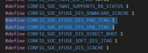

I am little bit confused about In JTAG source control table EFUSE bits are given like this EFUSE_DIS_PAD_JTAG = 0, EFUSE_DIS_USB_JTAG = 0 and EFUSE_JTAG_SEL_ENABLE= 1. But in Sdkconfig.h file EFUSE bits are set to EFUSE_DIS_PAD_JTAG = 1 and EFUSE_DIS_USB_JTAG = 1 .
Is this configuration works for inbuilt USB_SERIAL_JTAG ? If not how to change this bits in sdkconfig.h file.
