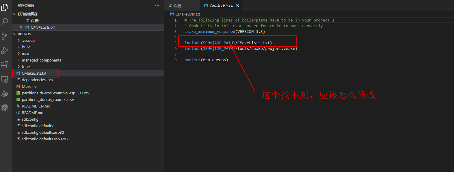

idf版本5.1
错误日志如下:
CMake Error at CMakeLists.txt:5 (include):
include could not find requested file:
/CMakeLists.txt

* 终端进程“C:\WINDOWS\System32\WindowsPowerShell\v1.0\powershell.exe -Command cmake -G Ninja -DPYTHON_DEPS_CHECKED=1 -DESP_PLATFORM=1 -B d:\Download\esp-adf-master\esp-adf-master\examples\dueros\build -S d:\Download\esp-adf-master\esp-adf-master\examples\dueros”已终止,退出代码: 1。
编译报错esp_dueros

- 4CA3002B-CEE3-4f68-8768-D096B4B3A019.png (45.13 KiB) Viewed 37327 times

Re: 编译报错esp_dueros
您需要额外配置 ESP-ADF 的路径,请参考 ESP-ADF 编程指南 https://docs.espressif.com/projects/esp ... ml#windows
