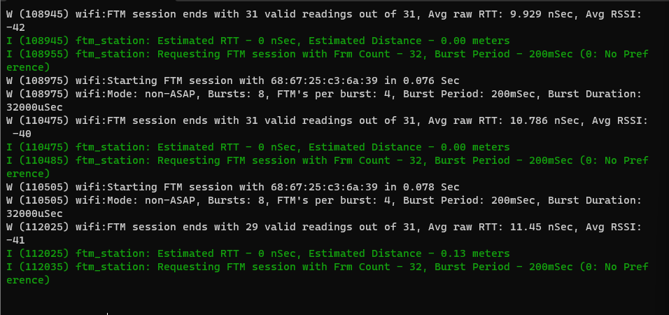

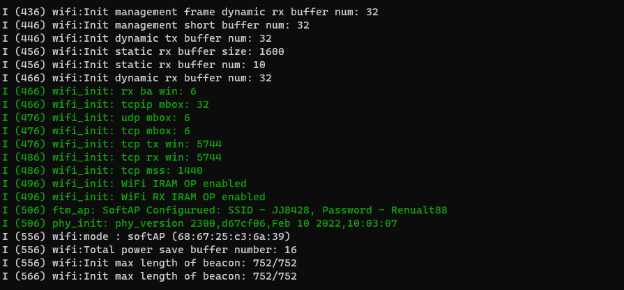

Postby JJ8428 » Thu Aug 10, 2023 4:54 pm
Hey, I have 2 ESP32s2 on my hand. One is acting as an initiator. The other is acting as the responder. The wifi FTM works for a while, however, after 2 or 3 minutes, the FTM stops. I'm not exactly sure what is going on. I don't believe my code has any data leaks, and I browsed the forums to find a similar post (viewtopic.php?t=24226), but there is no solution or follow up afterwards. Does anyone have any input on what I could be overlooking? I am fairly certain its the responder having some issue. I attached 2 screenshots which shows what each board with their respective code, outputs to the terminal. In the responder screenshot, everything seems fine, but for the initiator screenshot, it just stops in the middle of a FTM request to the SoftAP at the responder.
FTM Responder Code: Just serves as a Soft AP for the FTM initiator to connect to

FTM Initiator Code: Performs wifi FTM measurements within a while loop near the end. There are some extra imports and variables not used, but I have some additional functions commented out that relate to the example code.

Additionally, I faced the same issue on Arduino, but when I made a post on that here, nobody responded, so I thought the ESP-IDF would resolve the issue.
I should also be clear I have not touched the menu config at all.
