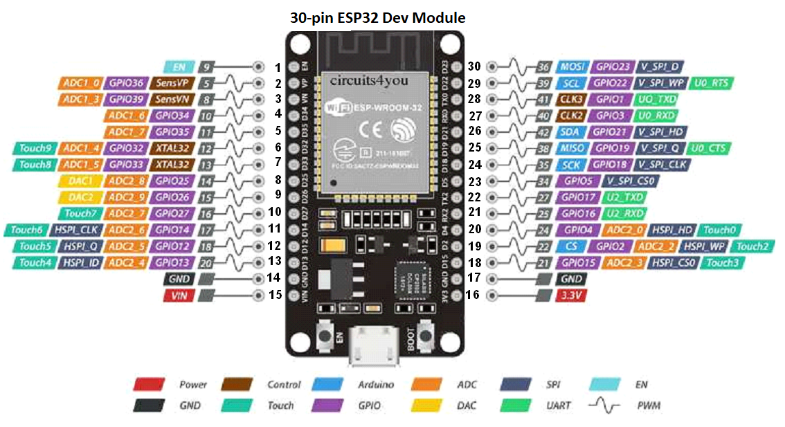

I have been using the following ESP32 Dev Module. I am interested to know --
1. Safe range of DC voltage that can be applied at VIN-pin.
2. Does the onboard regulator produce 3.3V from VIN?
3. Are ESP32's pins 5V tolerant?
4. How much is the sink and source current of a pin ESP32?

MicroController
- Posts: 2663
- Location: Europe, Germany
Re: How much DC Voltage can be applied at VIN-pin of ESP32 Dev Module?
and
https://www.espressif.com/sites/default ... design.zip
If you feel like taking chances, you can try 6 or 7V, but that may quickly burn the "power" LED on the kit.
Sink: 28 mA
and
Disclaimer: DO NOT EXCEED 5V ON Vin. Damage, fire or injury may occur if you do.1. Safe range of DC voltage that can be applied at VIN-pin.
Yes.2. Does the onboard regulator produce 3.3V from VIN?
NO.3. Are ESP32's pins 5V tolerant?
Source: 20/40mA4. How much is the sink and source current of a pin ESP32?
Sink: 28 mA

Source: 20/40mA
Does above mean --
20 mA continuous rating at 3.3V ?
40 mA means what?
Does above mean --
40 mA means what?
MicroController
- Posts: 2663
See "DC Characteristics" in the datasheet.
Pins powered from the VDD_SDIO power domain only source 20mA, the others source 40mA.
