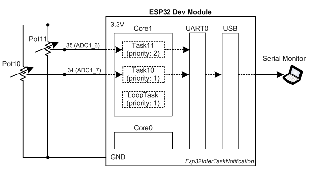

How does FreeRTOS allocate more service time (CPU cycles) to higher priority level task?
GolamMostafa
Posts: 19
Joined: Sun Jul 23, 2023 12:30 am
Postby GolamMostafa » Sun Aug 27, 2023 2:55 pm
I have been experimenting with the following setup (Fig-1) and the sketch to understand the mechanism of FreeRTOS in allocating more time to Task11 (with higher priority level 2) than Tasks10 with priority level 1. Would appreciate you explain this mechanism.
Sketch:

Posts: 10599
Re: How does FreeRTOS allocate more service time (CPU cycles) to higher priority level task?
Postby Sprite » Mon Aug 28, 2023 12:49 am
It won't. Given different priorities, FreeRTOS always allocates 100% of the time to the highest-priority task that is not blocking: it will always run that task until the task runs into something that de-schedules it (like the vTaskDelay in your example). See also here.

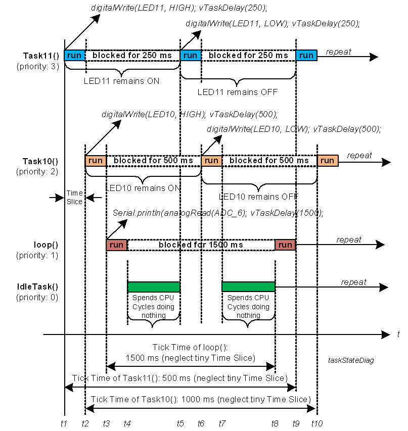

I have prepared and tested the following three tasks sketch that blinks three LEDs concurrently at different blink rates. Are there anything exaggerate particulalry on the definition of Tick Time and Time Slice (Fig-2)?
Schematic:
Figure-1
Task State Diagram:
Figure-2:
