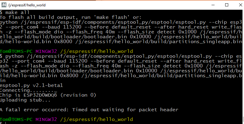

I'm having a problem loading compiled programs into the esp32.

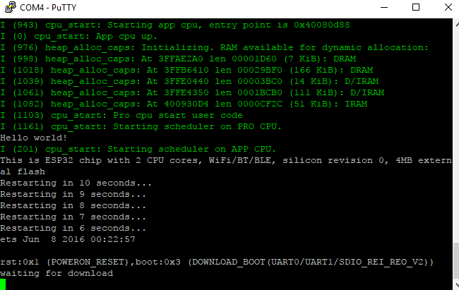

Initially I built the hello_world example on Ubuntu running in an Oracle vbox and flashed it fine - monitor showed it restarting and printing its message over and over again.
I then tried a different program to try flashing some leds and started getting the error. (See ) I thought it might be a timing problem caused by vbox and so I installed the IDF on my Windows10 host so the USB would be direct. But I'm getting the same problem. I tried to manually set the esp32 into boot mode ( and then flash without the --before default_reset but to no avail.
Any suggestions would be appreciated.
Thanks
Tom
FW load getting A fatal error occurred: Timed out waiting for packet header

The board in question is a DOIT Devkit V1. I tried a couple of usb cables with no luck; however, I also tried a second usb->uart connected to uart0 and this works for flashing but I have to reset manually as the usb doesn't breakout rts/cts/dtr (as well the board doesn't appear to break out GPIO 0). So my guess at this point is that the on-board usb->uart isn't working properly.
