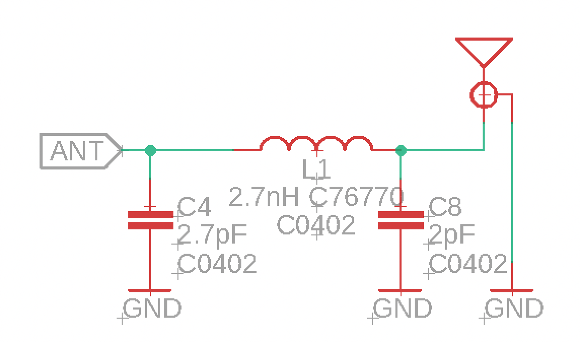

Hi everyone,
I'm working on a custom PCB board based on ESP32-C3FH4 chip.
HF part doesn't seem to work correctly: softAP is not created until I reduce the TX power to 28 or less (WiFi.setTxPower(WIFI_POWER_7dBm)).
It appears that there is a critical problem with the impedance of the antenna path.
It is 2-layers board (1.6mm thickness, 1oz copper weight) from JLC PCB.
I used typical PIFA antenna (TRACE_ANTENNA_2.4GHZ_15.2MM from SparkFun-RF) and general matching PI filter 2pF - 2.7nH - 2.7pF in 0402 packages. Trace is as short as possible, 16millis and 10millis at chip pin.
When designing I knew that these values are for 4 layer board, but I didn't thought it would be so much critical.
All 5 boards that I have, have the same issue.
I looking for ideas to fix this issue. I could have access to network analyzers but I have no idea how to connect network analyzer to such a small traces.
Best regards,
Michal

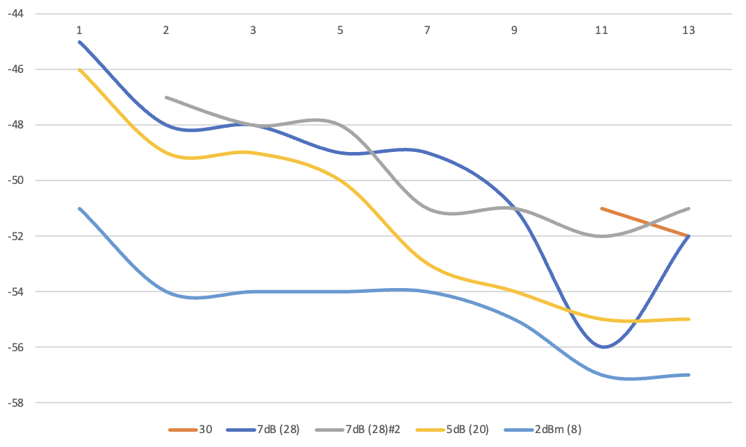

I created an arduino sketch for changing channel and TX power.
I fixed position of a board and fixed position of my USB dongle used as receiver.
I am attaching the measured RSSI for various TX power and channel:
Zrzut ekranu 2023-09-11 o 19.38.42.png (75.44 KiB) Viewed 11714 times
Zrzut ekranu 2023-09-11 o 19.38.32.png (47.68 KiB) Viewed 11714 times

I removed whole PI filter and it started working fairly good. Still looking for approach to match it correctly
Posts: 10593
Re: ESP32-C3FN4 - Custom board, no WiFi
Postby Sprite » Tue Sep 12, 2023 3:59 am
Wrt VNA matching etc: you'd generally use the ESP RF Test Tool for that, iirc it comes with documentation as well. https://www.espressif.com/en/support/do ... ther-tools . From looking at the RF teams desks here, connecting the VNA to the PCB comes down to very thin coax pigtails and good soldering skills, I'm afraid.
