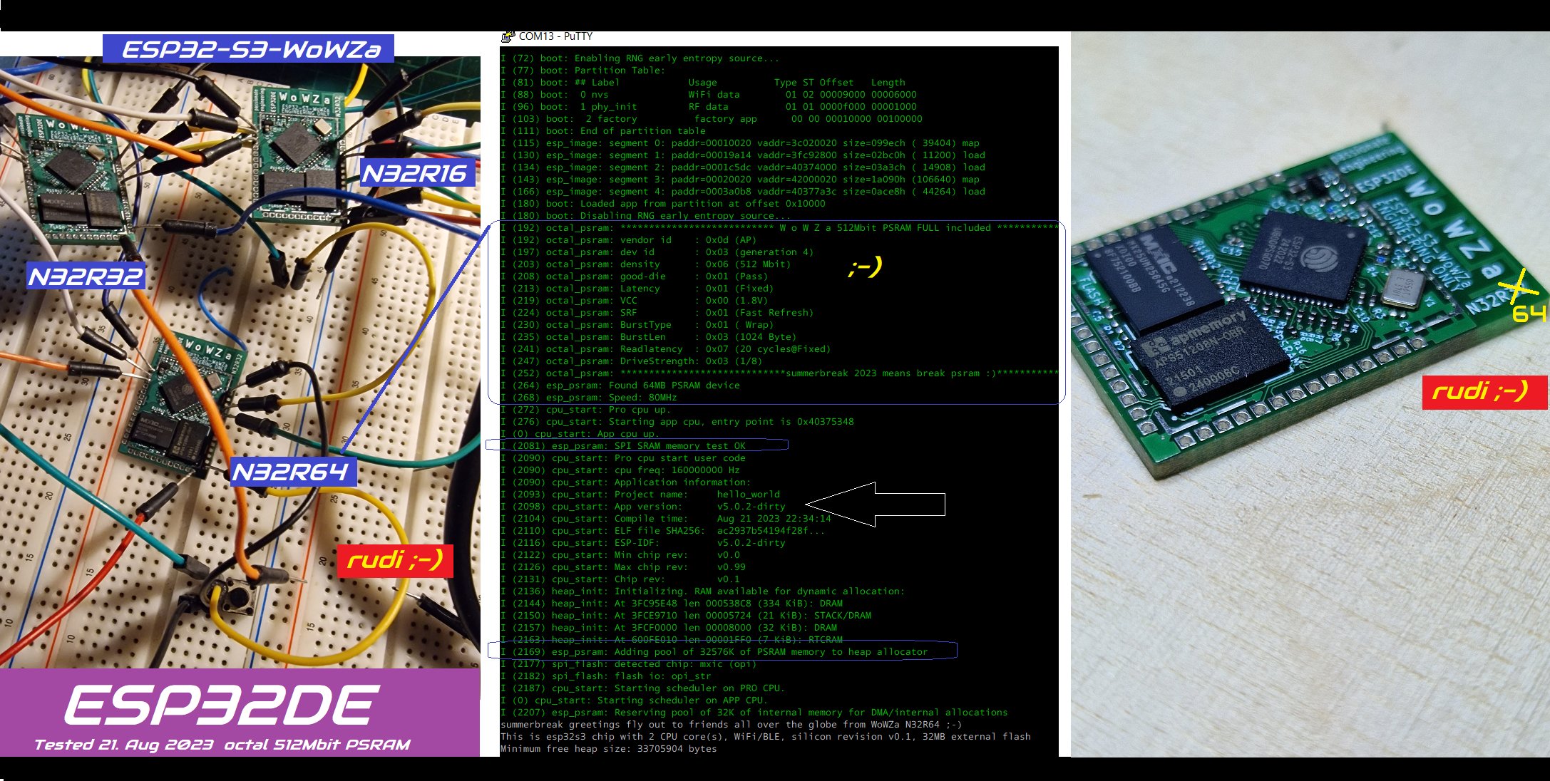

N e w M i l e s t o n e
update 25. Aug 2023
tweet || github:
  • build things new and different from scratch
  • get 16 MB PSRAM working in the Linux Port for Xtensa MCU ESP32 S3
  • optimize linux kernel for IoT RAM also eMbedded System
  • optimize boot time
  • used engineering modul "ESP32-S3-WoWZa-N32R16"
used modul: "ESP32-S3-WoWZa-N32R16" Release date 13. Oct 2023
preTest was successful in ESP-IDF-5.0.2-dirty with 16MB(128Mbit) RAM, 32MB(256Mbit) RAM and 64MB(512Mbit) RAM ( you get 33.. MB in the heap allocator out of the box)
ESP32-S3-WoWZa-N32R64

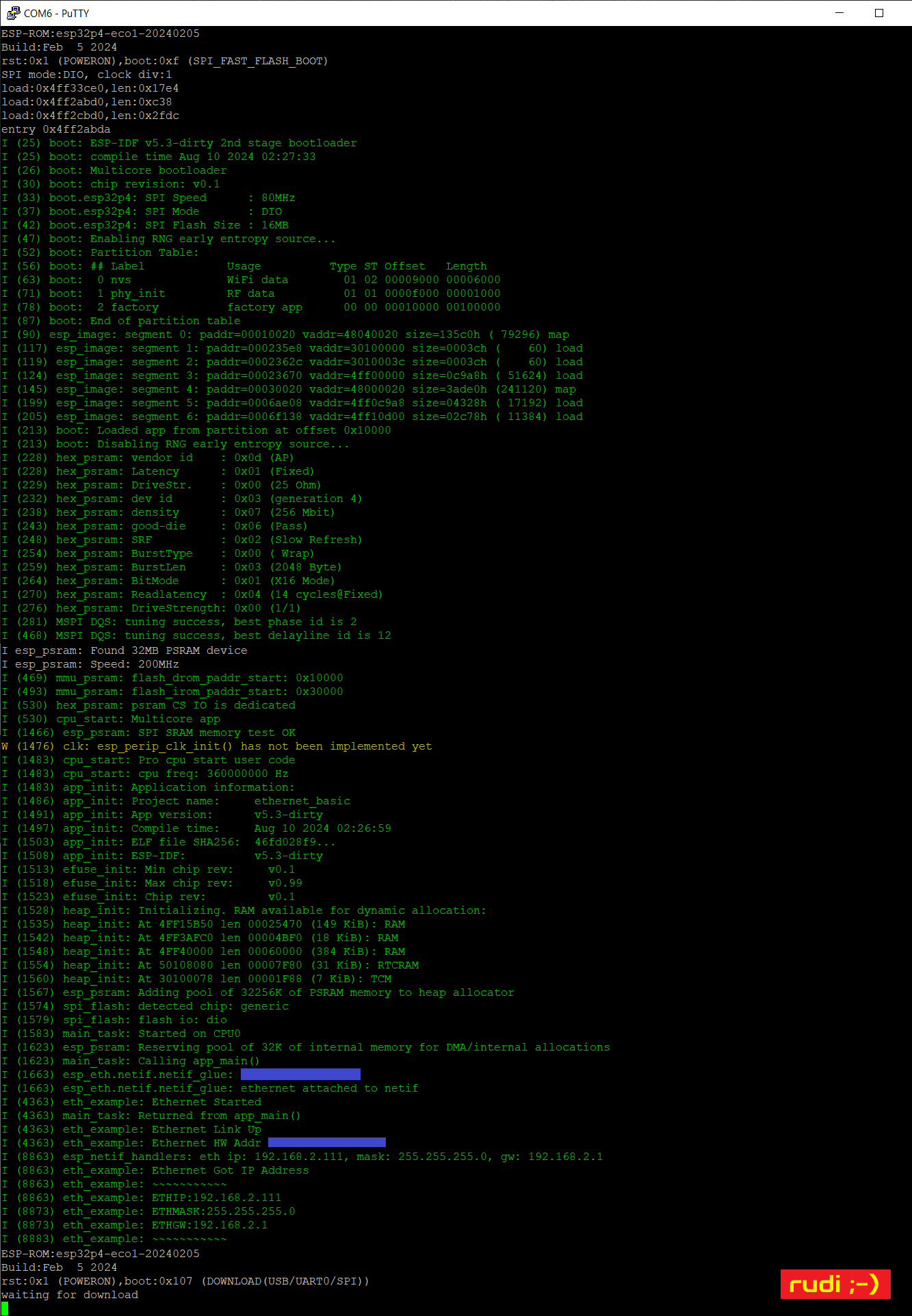

ESP32-P4 is just in time from my knowing V0.1 and works great!
they are also on the ESP32-P4-Function-EV-Board just in time, but this can be change - no binding.
ESP32-P4-NRW32 which has 32MB psram is today on the workbench for now, ..will have to test something with it .. :D
JFYI ESP-P4 Networking is allmost working out of the box
ESP32-P4-NRW32 Network IP101
