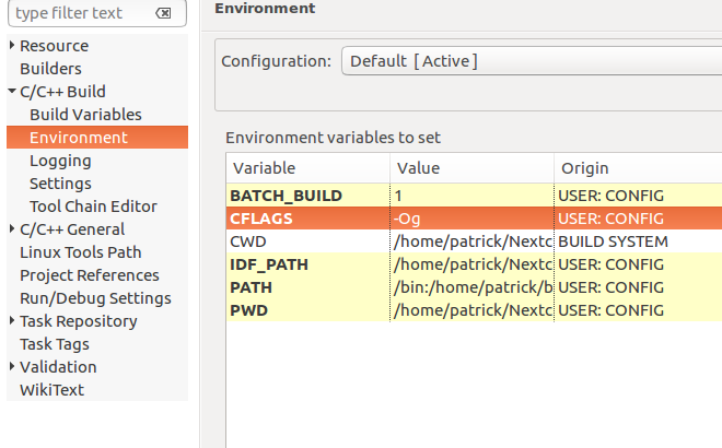

Hi all,
I would like to disable any optimization of the C code. I am using the Eclipse IDE, having the CFLAGS env variable set to optimize for gdb.
It this the right approach? When debugging via JTAG, I still can see cases when I hover over a varaiable, it says "Optimized Out".
Thanks and best regards
Patrick
Disable optimization (optimize for JTAG debugging)
- eclipse-disableOptimization.png (59.64 KiB) Viewed 9744 times
