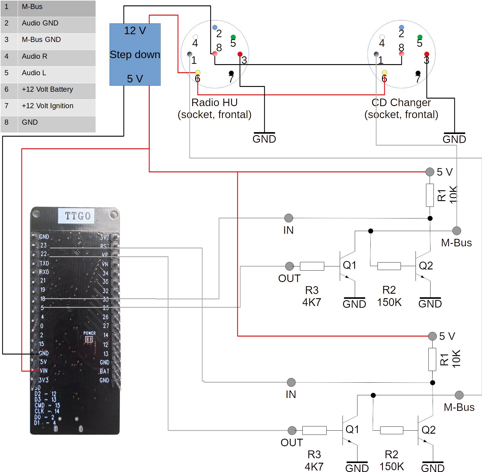

To get things sorted (and before heating the soldering iron), I've made a kind of diagram of what I understood is your concept (does your radio/changer also comes with the 8-pin DIN sockets?). Would you mind to have a look at it?
What I still don_t understand is the part
etc. I deduce that you are also planning to use a relay to switch between sources? I've noticed that some of the pins you list in config.h aren't available on my Ep32 Wrover board (see diagram).

ninja: build stopped: subcommand failed.To get things sorted (and before heating the soldering iron), I've made a kind of diagram of what I understood is your concept (does your radio/changer also comes with the 8-pin DIN sockets?). Would you mind to have a look at it?
// OUTPUTS
// 13 AUDIO RELAY CDC
// 16 AUDIO RELAY BT
// 17 AUDIO RELAY INTCD
// 21 AUDIO RELAY AUX
// 19 MBUS CHANGER OUTBTW: I tried the onboard Bluetooth of my Esp32, merging Phil Schatzman's software with Oliver's M-Bus emulator sketch - worked fine out-of-the-box. I integrated an old DAC (PhatDac) I had lying around to get a decent sound quality; the only drawback seems to be that there is no library for the Esp32 that includes handsfree...

Regarding circuit design
Interesting! I looked at using the esp32 too for bluetooth but my idea behind the csr8675 was, it's already a decent bluetooth handsfree with better codecs (aptx-hd/aac for higher bitrate than default a2dp codecs) and some noise canceling goodies. There is a port of APTX to esp32 but haven't found any handsfree code for the esp.

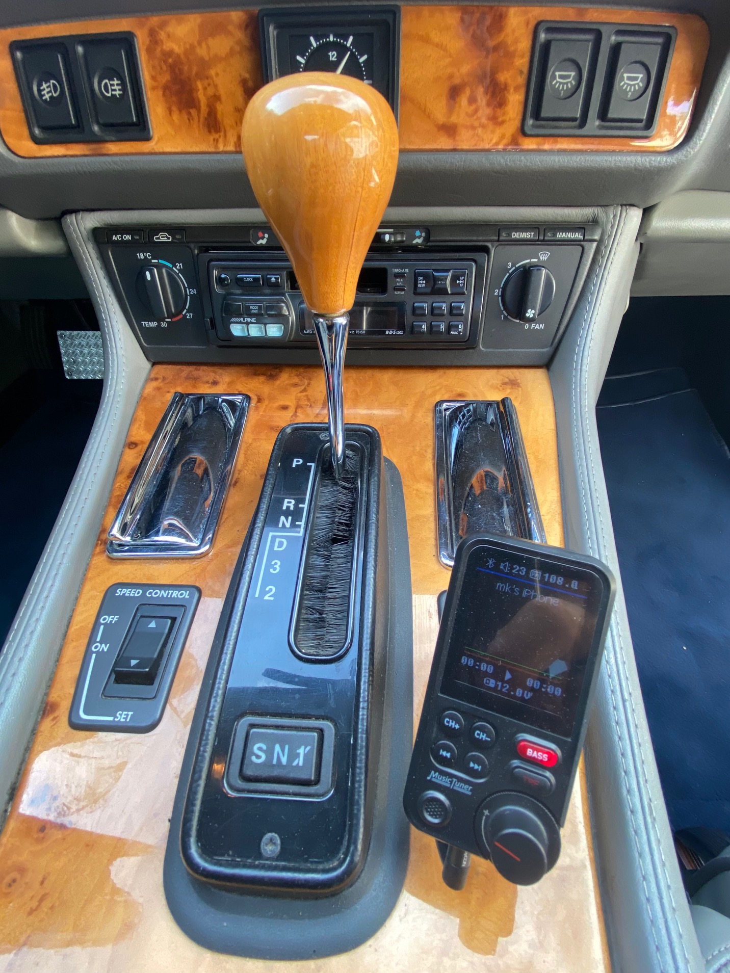

I finally managed to compile without errors on Windows. Besides vim, I also had to install sed (!) for WIndows in order to get rid of the errors.For Windows you need to install nodejs and mingw64 and include the binfolders in the PATH variable. Specifically it needs 'xxd' which is provided by vim-common package.
I had a look at your PCB design - wow, this looks like serious stuff...! Did you leave the BT module out or was it simply me not finding it?
Talking about bluetooth: I’ve changed my plans a little bit. On one hand, I’ve got used to the commodity of having a kind of remote control for the radio, as the concept of the old Alpine HU (only push buttons, even for volume…) is not my favorite way to interact. I'm more the rotating-knobs-type
So, in a first step, I decided to „outsource“ the entire Bluetooth/Hands-free part to an 15-Euro-Adapter plugged into the cigarrette lighter (which happens to be nicely placed in my Jaguar):
The adapter comes with AUX out which I connected to the CDC audio lines. Thus, I have a whole bunch of additional features, as handsfree phone calls (the adapter comes with an inbuilt mic), Siri VC, USB for quick charging, equalizer, song control with push buttons (play/pause/skip/forward etc.) and so on.
And on the other hand, I’m very interested in having DAB+ radio in the car. So I looked around – and what I’ve just ordered is this: https://www.alpine.de/p/Products/SingleView/ezi-dab-bt
It combines the features of the 15-Euro-Adapter with a DAB+ receiver, and I liked the idea to have the control unit completely wireless (will have to see whether hiding away the actual receiver and DAB antenna in the dash will allow for a good signal).
This means that I'm back to only need an emulator that only opens the audio input from the CD changer.
William, would it be possible to compile your code for this on an Esp32, i.e. without fancy things like bluetooth or switching between sources? Would I need to change sth. in zthe sources? (hopefully not, because further than editing comments or change some pin assignation I'm really unable to code on this level...).
Having a version based on Picoharis Code ported to Esp32 would be very helpful in general, as the ATMega128 are rather impossible to get. I know that there are some guys in a German Arduino forum hoping for a port, too...
