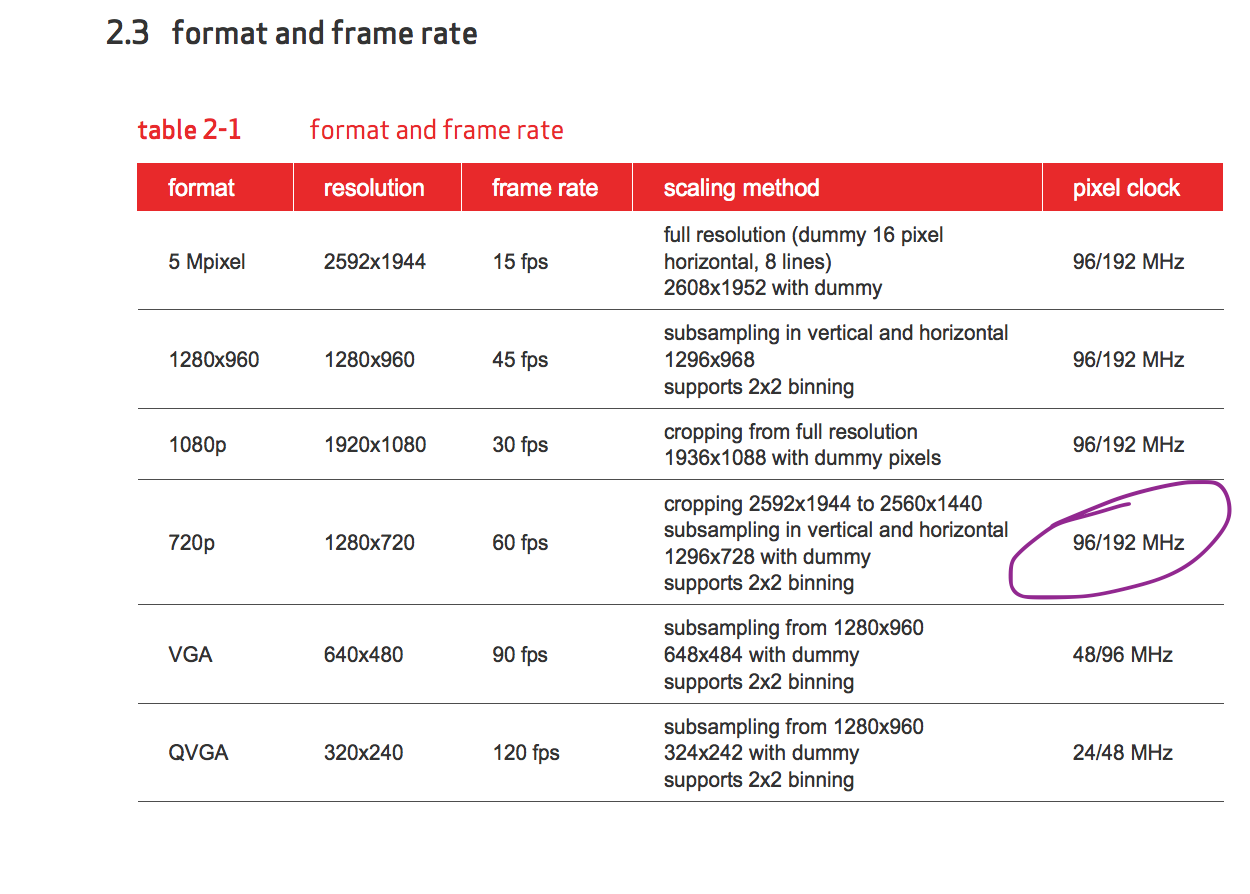

I would like to build a wifi camera using esp32 and the OV5640 Camera
http://www.arducam.com/camera-modules/5mp-ov5640/
Since I'm new to this I would like to know if it is possible to stream at 60 FPS with 720p resolution.

Don't have any numbers but if the radio throughput would be the limiter then you could change JPEG compression ratio and get that framerate. In general such cameras don't give superb image quality and with lossless JPEG they generate much less data than machine vision cameras with raw formats.
Short answer: you have to test it.
igrr
Posts: 2077
Re: ESP32 + OV5640 Camera
Postby igrr » Mon Jul 31, 2017 11:31 am
The other limiting factor would be the pixel clock. Currently only 20MHz has been achieved, and even at that clock rate there are some occasional glitches in the data. This isn't noticable in raw/rgb/yuv modes but in jpeg mode these glitches introduce noticable artifacts once in every few frames. This happens on WROVER-KIT board. I don't know if that is a signal integrity issue related to board layout or some issue intrinsic to the ESP32. I suspect board layout, but since that is the only board I can experiment with, can't prove that it is the case.
I think that for 720p at 60fps you would need higher pixel clock than 20MHz, but you would need to check camera datasheet for that.

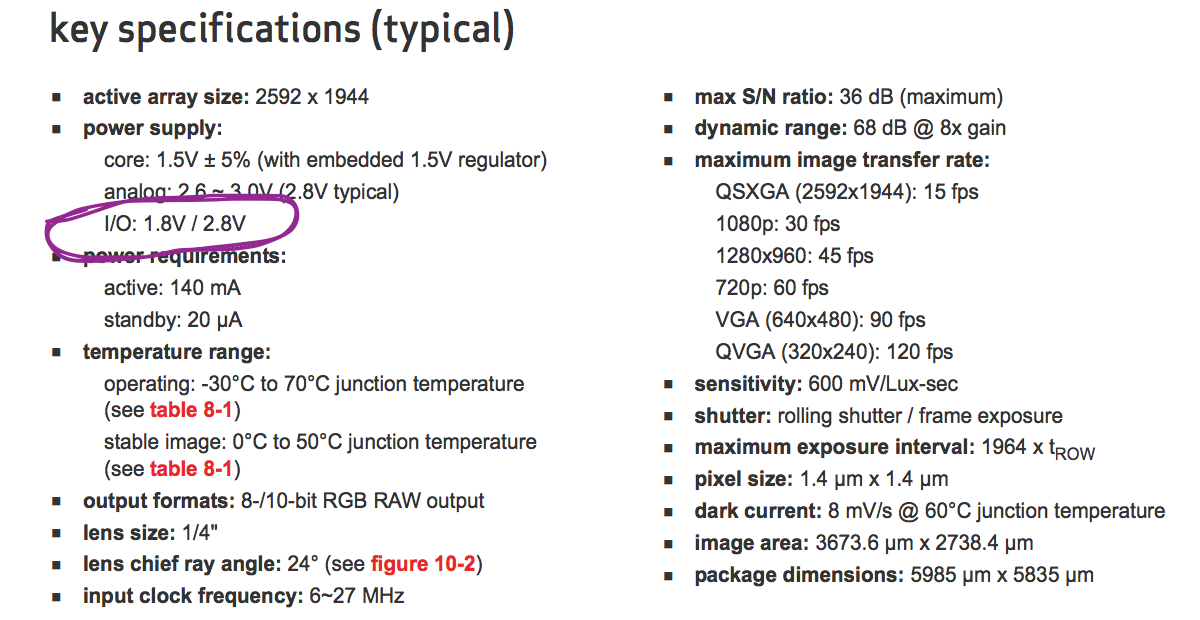

My suggestion is to obtain and read OV5640 datasheet first, before ordering.
Screen Shot 2017-08-01 at 18.36.14.png (183.16 KiB) Viewed 33597 times
Screen Shot 2017-08-01 at 18.38.06.png (212.53 KiB) Viewed 33597 times

ov2640, ov3640, or ov5640 are similar serial of CMOS camera. However, their core voltage is not the same.
