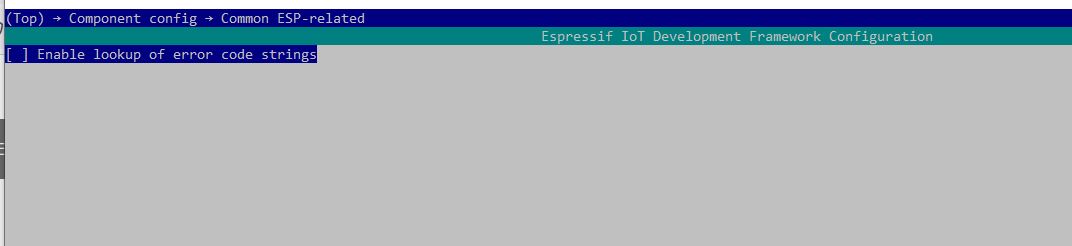

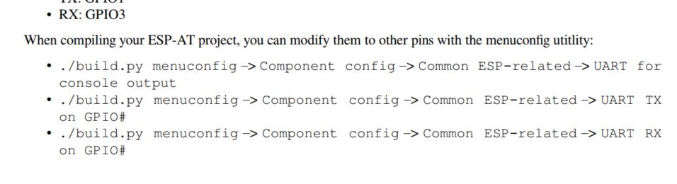

According to documentation ESP-AT User Guide [v3.2.0.0] it is possible to change the pins of the log port. But when I'm in menuconfig I don't see such an option.
- doc_esp.JPG (39.78 KiB) Viewed 31373 times
- screen_esp.JPG (26.45 KiB) Viewed 31373 times

Many thanks for your report! you are right. The document is outdated due to ESP-IDF version upgrade.
The right way to modify the pins of the log port as following:
- ./build.py menuconfig -> Component config -> ESP System Settings -> Channel for console output -> Custom UART
- ./build.py menuconfig -> Component config -> ESP System Settings -> UART TX on GPIO#
- ./build.py menuconfig -> Component config -> ESP System Settings -> UART RX on GPIO#
will update esp-at document in two weeks, thank you.
