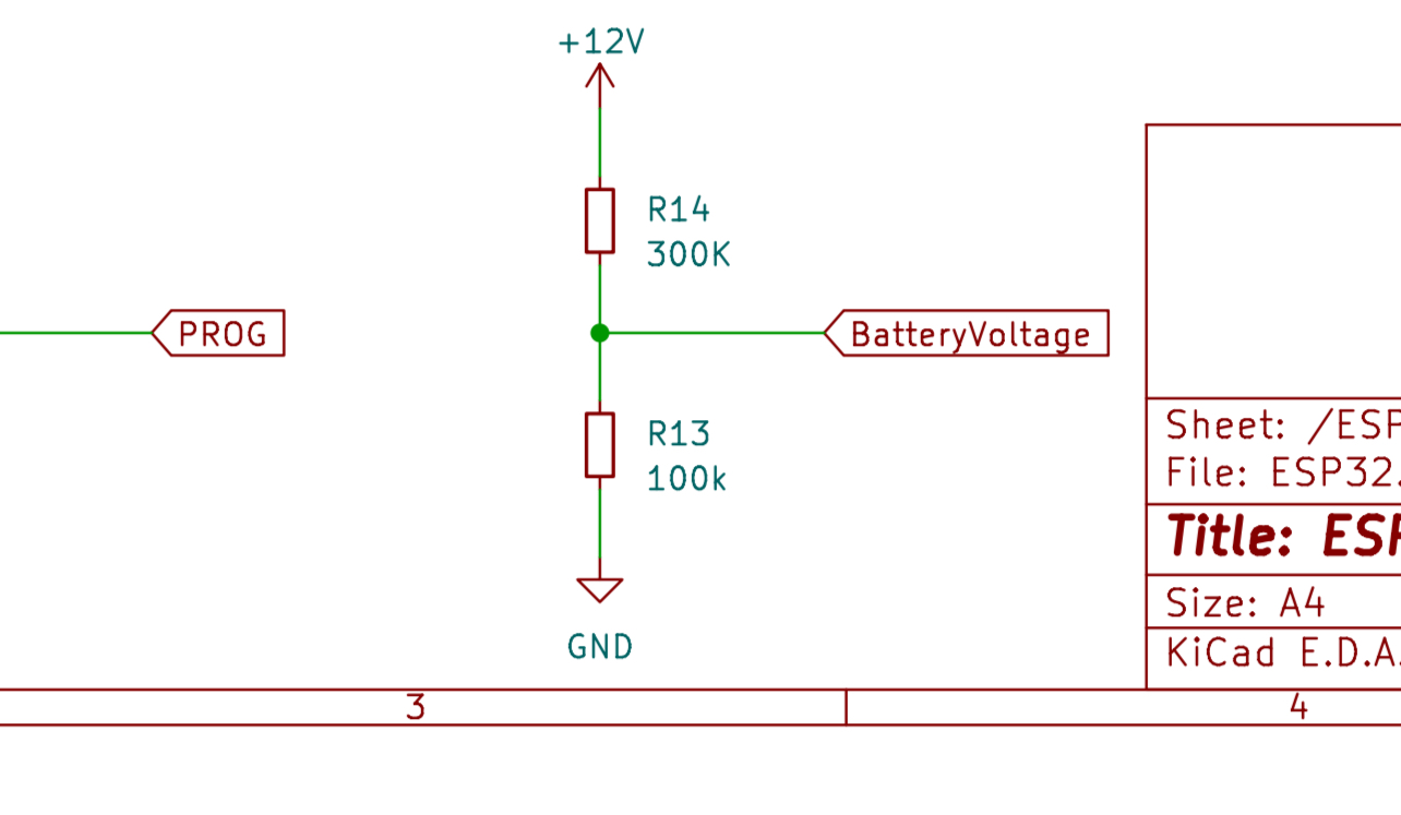

Hi, I wrote this implementation to calculate the battery percentage using the voltage however the battery percentage readings seem off and the output stays at 100 percent for most of the time. Can you spot the issues in the code?

double adc = returnBatteryVoltage();
// Calculate the ratio of the value within the source range
//Attenuation Low = 150 mv
//Attenuation High = 2450 mv
// Battery voltage scale (10V to 12.6V)
double vrs = mapValue(adc, 150, 2450, VOLTAGE_MIN, VOLTAGE_MAX);
The code assumes that the battery is close to 0.6V (i.e. ~150mV from the voltage divider) when empty.
Try this:
#define ADC_FULL (2450)
#define ADC_EMPTY ((int)((ADC_FULL * VOLTAGE_MIN) / VOLTAGE_MAX))
double vrs = mapValue(adc, ADC_EMPTY, ADC_FULL, VOLTAGE_MIN, VOLTAGE_MAX);
And btw, 300kOhm/100kOhm are too big for the ADC; impedance should be <10kOhm, IIRC, so 3kOhm/1kOhm will yield better results. Or, if the ADC is only sampling periodically, you can try putting a small (0.1-1uF) capacitor across the 100k resistor instead.
