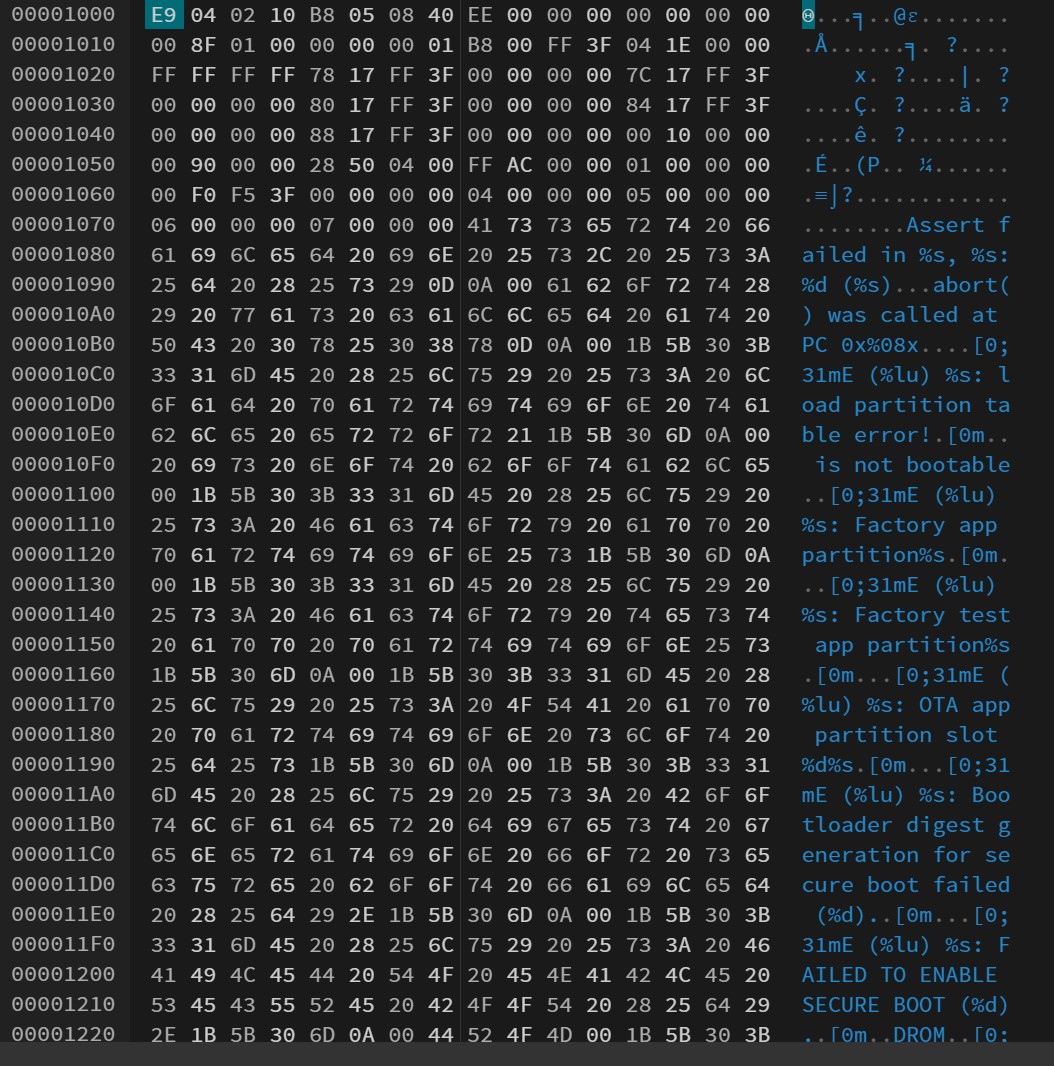

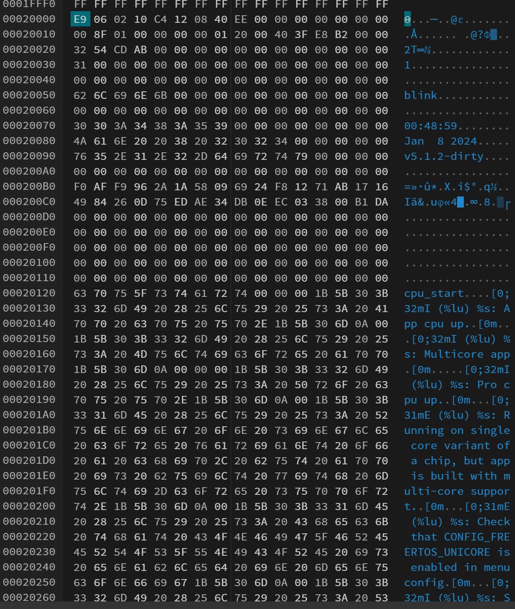

Below is project partition table map
# ESP-IDF Partition Table
# Name, Type, SubType, Offset, Size, Flags
nvs,data,nvs,0xb000,24K,
phy_init,data,phy,0x11000,4K,
factory,app,factory,0x20000,1M,

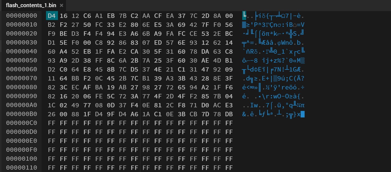

I already read current data in flash memory.
Below are some image of data in flash with realative address.
at 0x00:
bootloader at 0x1000
app at 0x 20000
Could you help me to check if there is any problem here?
Actually, I rebuilded project before write to flash. Could it be problem?
