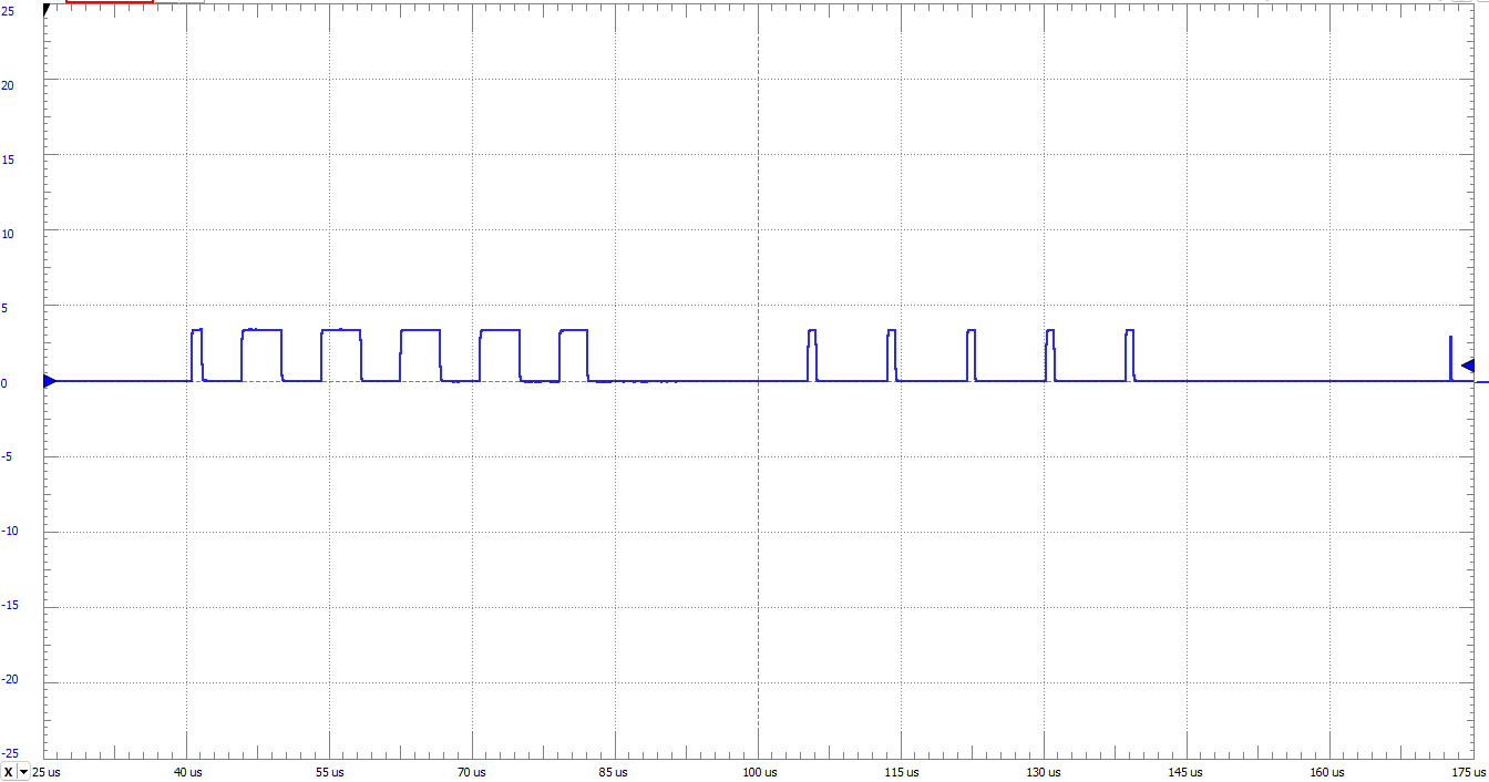

Hi guys,
I am tinkering around with the rmt peripheral and understand it is an amazing tool to generate complex and changing waveform overtime. I need to generate a certain amount of pulses over a GPIO that I would like to vary in terms of number of pulses, frequency and duty cycle. Here is my current code :

Basically what I do is configure the RMT to use a carrier . The carrier is where I define my frequency and duty cycle. I then write an item whose duration allows me to get the number of pulses I would like. Basically, I see it that the item I write is a mask that will ultimately get me the number of pulses I wish for. It works quite well and allows me to have a dynamic number of pulses. However I have two main issues :
1- Sometimes, I can get one more pulse and the one at the beginning and at the end of my wave of pulses are no longer of the width I look for . This tells me my item is not synchronized with the rising edge of my carrier and so my method of masking does not work.
2- When I run the code above, I expect to continuously send a wave of 5 pulses and expect each wave of 5 pulses to have a different duty cycle. The problem is that I have a huge delay between two successive waves that varies between 20 microseconds to 40 microseconds. How can I make it so that this delay is minimized. Ideally, I would like the waves to be sent successively almost indistinguishable from a non interrupted PWM. Is that possible ?
You can see below both problems (supposed to be 5 pulses at 50% duty cycle 120 kHz followed by 5 pulses at 10% duty cycle 120kHz) :
My biggest problem really is the point number 2 because I really cannot afford 20 microseconds of delay in between two consecutive waves of pulses.
Thanks in advance
Screenshot 2024-01-10 141031.png (16.42 KiB) Viewed 36219 times

I managed to fix the delay between two consecutive waves of pulses being sent by disabling the interrupt for the channel I use and simply launching my function sendPulses at regular interval. The delay between the pulses being sent becomes then exactly equal to the interval without the additional delay that I was observing. I suppose the delay is mostly caused by interrupts in the background...
I still however have the problem of my carrier not being synchronized with my items. It is a matter of luck whether I start at the same time as the rising edge of the carrier. Any suggestion in this direction ?
