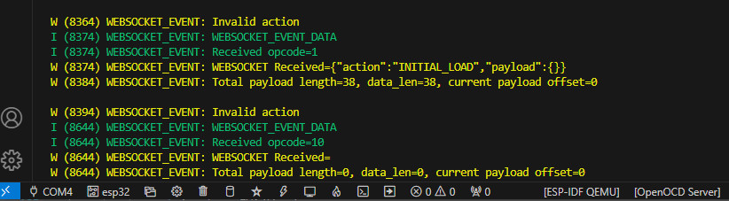

I'm doing small project using ESP32 connect to webserver with using esp_websocket_client.h.
Everything so far is ok but I have problem that after established connection to server and recieved information from sever, About 10s or 20s later, I check list device of server connection and saw that Module ID of ESP32 was dissapeared although event handler still recieve opcode =10. I try reset by RST button and check again, server still connect to device and always connection but something the issue happen --> The problem occurs randomly. I'm using framwork 5.2
I don't know why if Server is disconnect to client then Socket event have to recieve signal "Disconnected" but In my picture attachement below, The event still recieve opcode = 10 mean that Ping- Pong process ( hearbeat of Socket) still working.
See my code and picture below to more understand:

Hello
I also adjust all value about time but can't solve problem. After connection to server, around 5s later, Server lost connect to device. Another way I think, Is it problem come from server?

Hi
I just update some finding.
After download code, if I press button "RST" on board or run command
esp_restart()
, board will auto restart again and server will lost connection to device.
If I just dis-connect and connect USB, board connect to server as normal
