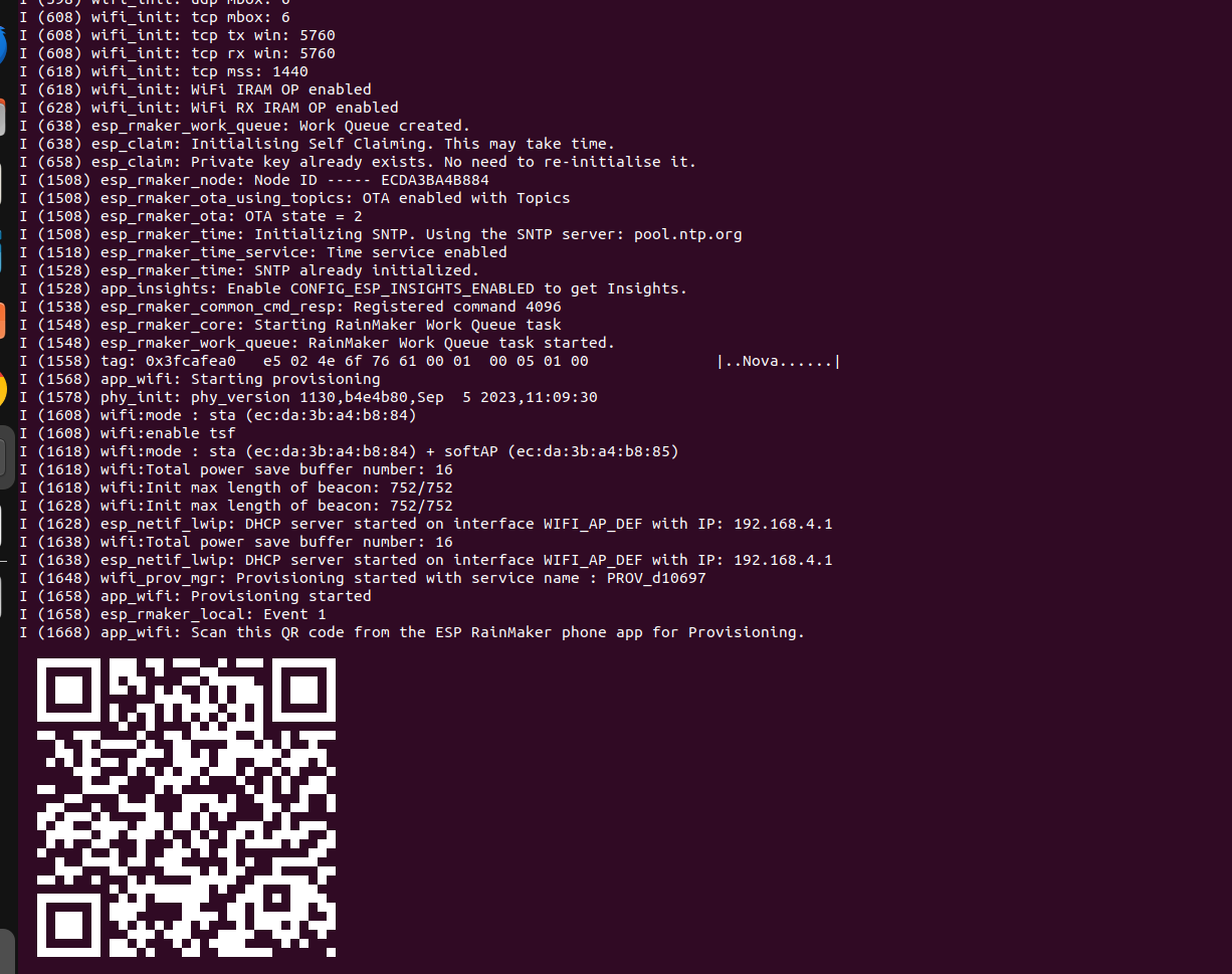

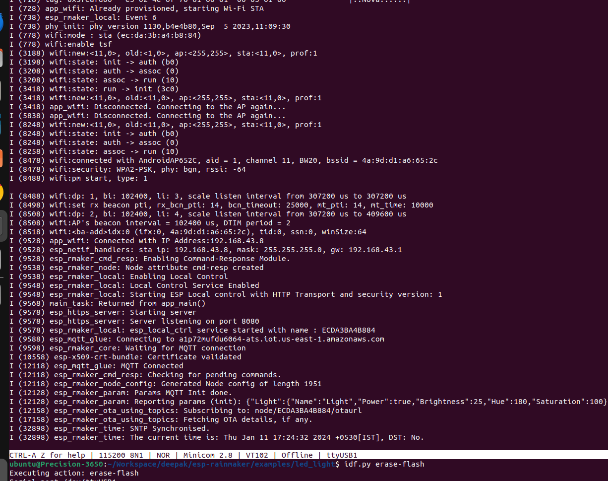

When I flashed the leg_light glowing application onto the ESP32 C3 module and attempted to connect to WiFi using the Rain Maker app provided by Espressif, I encountered an issue. While the device successfully connected initially, upon disconnection, it continued searching for the previous device even after resetting the board. This behavior necessitated re-flashing the board to establish a connection with another device using the Rain Maker app. Is there any solution to disconnect and restore wifi settings without reflashing the code

--->Wifi Display after flashing

---->Getting strucked here after disconnecting

Did you just reboot the board or pressed and held the boot button for 3+ or 10+ seconds as mentioned under the Resetting the board section of the docs?
