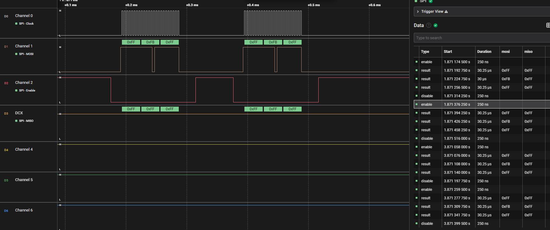

This one is not working and UART I am getting 0x00, 0x00 for both reads.
I investigated by connecting the logic analyzer (unfortunately due to my setup problem, I can't connect the logic analyzer when the slave device is connected, which means that I can see what is transmitted but not what is received which is always 0xFF)
The following is the output, as can be seen, the command is not transmitted properly, I don't understand why.

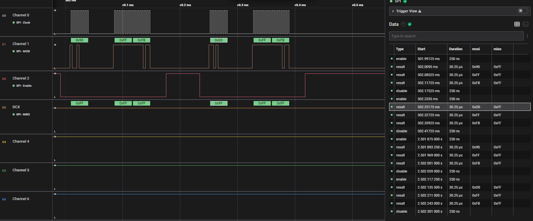

And this is also not working, while reading the data I am getting 0x00, 0x00. The waveforms on the logic analyzer are as below.
Here the transmitted commands are 0x90, 0xFF, and 0xFB, I don't know why 0xFF and 0xFB are transmitted, it should be 0x00, or maybe I don't know.

The 2nd waveform looks OK to me. You're not specifying any data to TX, so I imagine the driver simply sends dummy bytes. For the first waveform; the driver won't send the data in cmd unless you tell it to (I think it's a flag somewhere).

Thank You very much, your hint solved my problem. In the device configuration, I added "command_bits = 8", as shown below.
