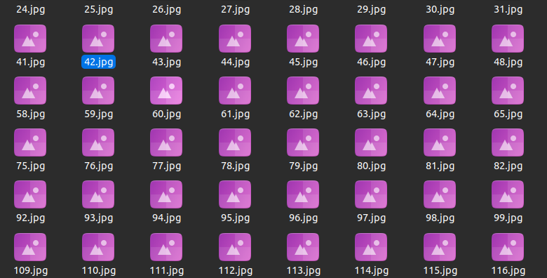

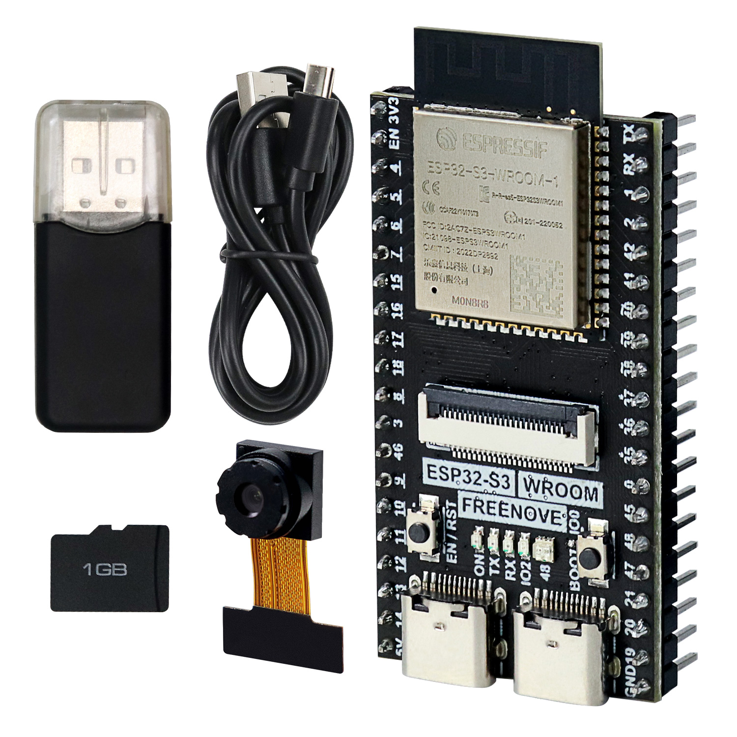

I have a ESP32-S3-WROOM module which has camera and micro SD card module. I can take a snapshot a PIXELFORMAT_JPEG photo. However, when I change the pixelformat with "PIXELFORMAT_GRAYSCALE", I cant save a valid photo.
Average SVGA colored JPEG photo takes about 25-35 kB space. However the pixelformat grayscale files takes 480.000 B constant. Also the files could not open. (Corrupted). Here is my code:

I also printed out the the image data to the Serial monitor. It is completely useless than JPEG pixel format image data.Weird thing is the saved files are 480 kB constant.
So anyone has an idea about this problem? Any idea can be useful.
The ESP32-S3-WROOM Module that I have.

Found it. The 480kB data is raw grayscale data which requires jpeg conversion. And there is a function for compressing this kind of compressions called "frame2jpg()".
Hope it helps!
