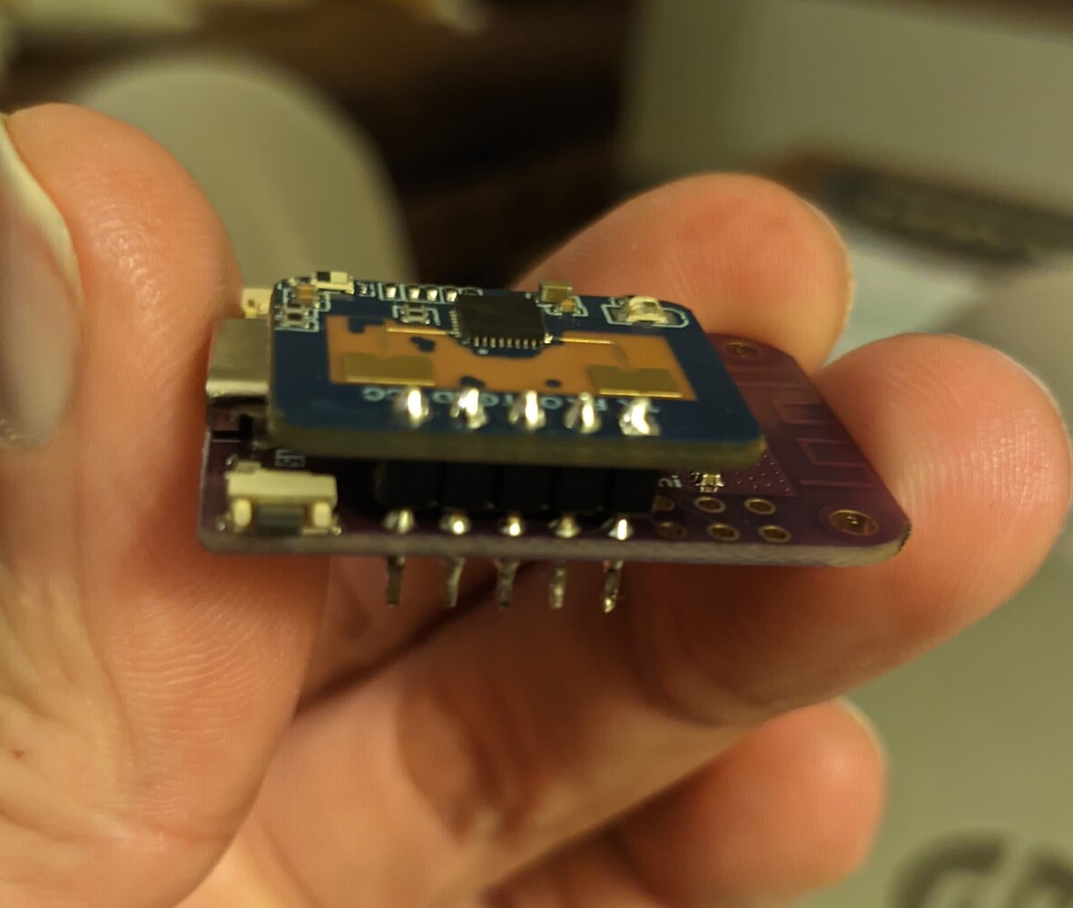

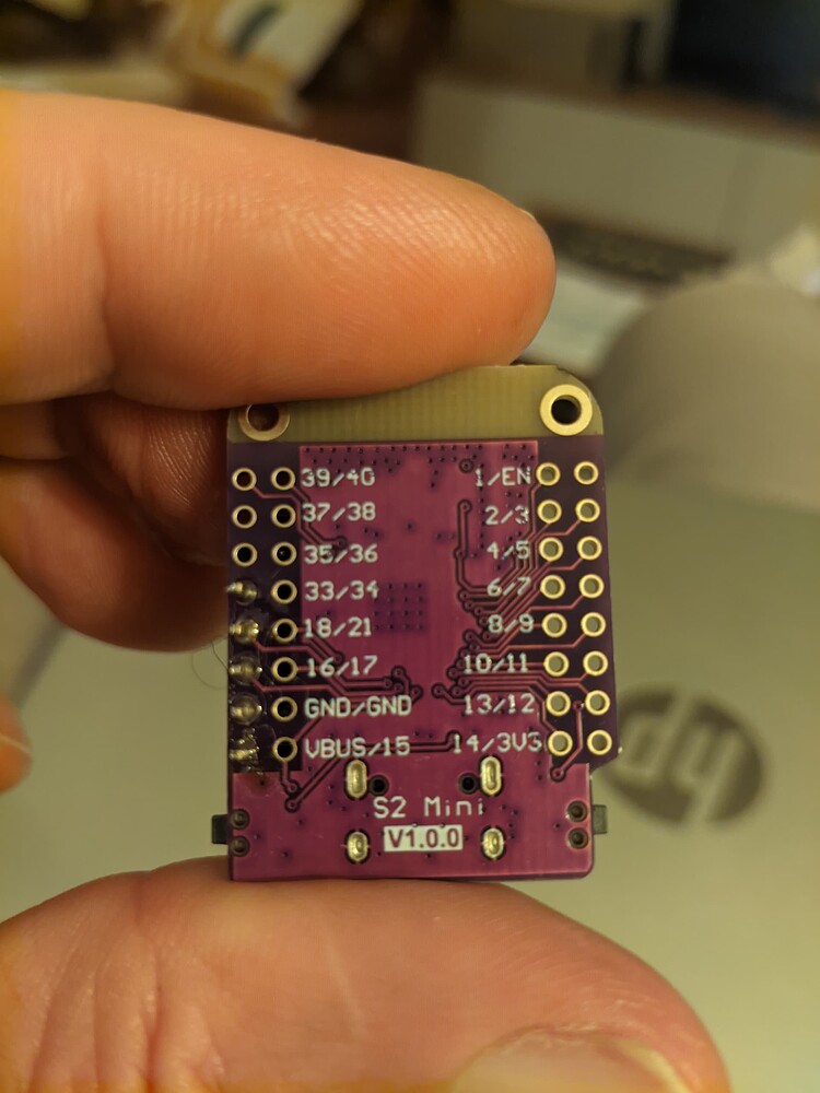

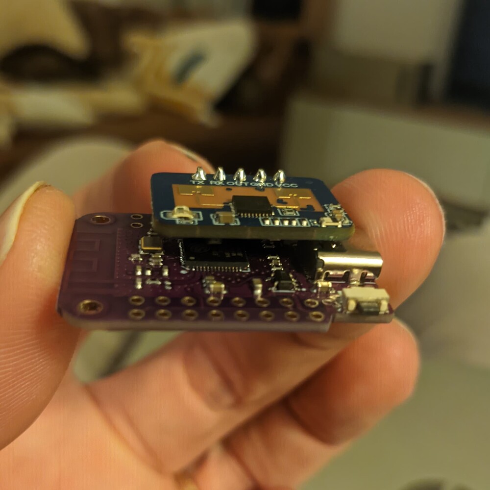

Hello
i want to make a presence detector. Prject
impossible to flash bye PC
it is possible to compile wirelessely, but flash dont work finally (code IS valides)
my code is

INFO Connecting to 192.168.1.56
ERROR Connecting to 192.168.1.56:3232 failed: [Errno 111] Connection refused"
It compiles but cant flash with ans without thé ld2410cmodule
Please help++++++

Postby lbernstone » Sun Feb 04, 2024 3:14 am
You would need to first flash a firmware via USB/UART that listens on the ArduinoOTA port
