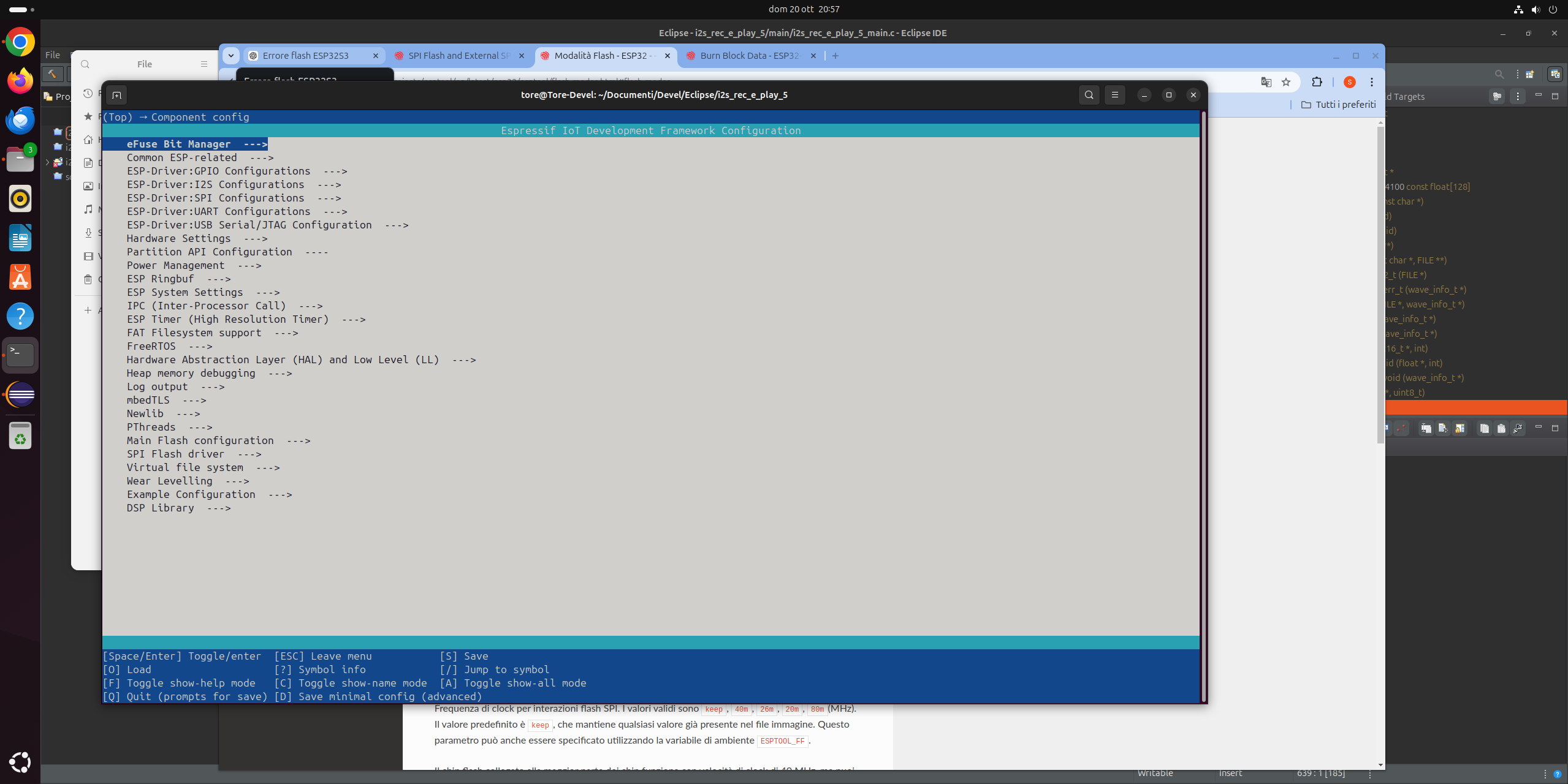

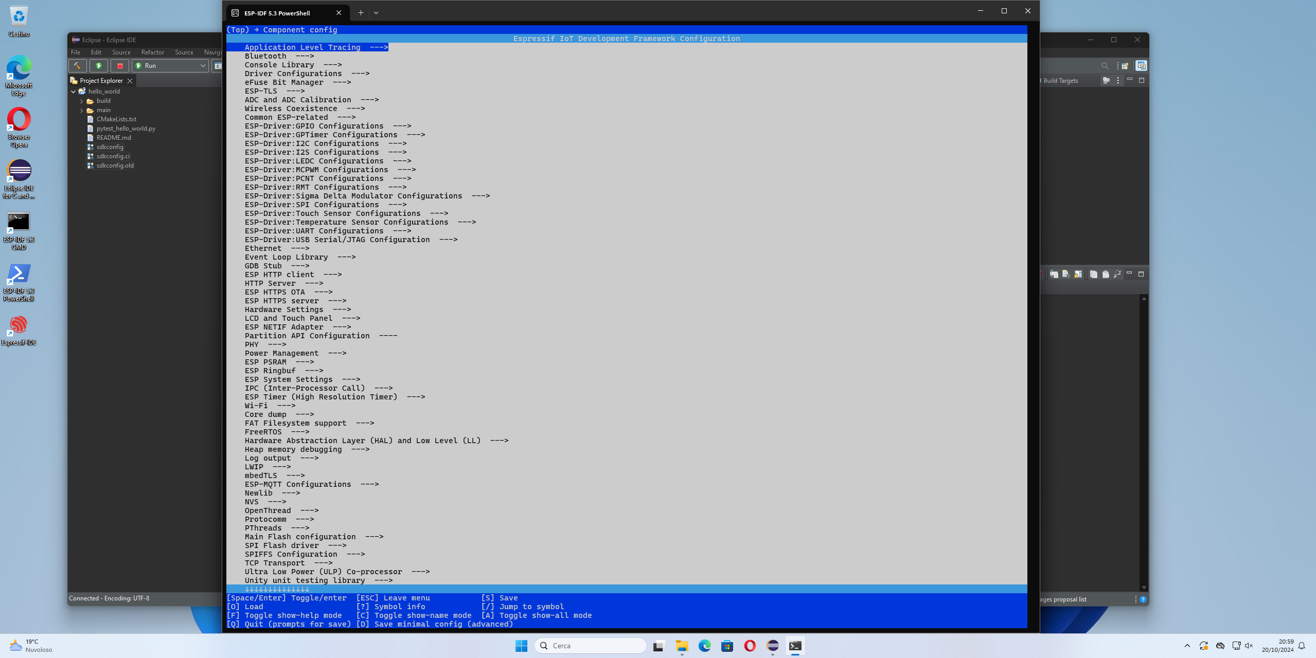

CityHunter71
- Posts: 5
- Joined: Sat Aug 17, 2024 6:06 pm
Re: hidden menu item of idf.py menuconfig
Hi, i have same issue, but is only on Ubuntu system and works in windows system.
on Ubuntu, with ESP-IDF 5.3.1 with clean install don't works
on Windows with same ESP-IDF 5.3.1 with clean install idf.py Menuconfig show many options.
I try to import form window into ubuntu sdkconfig sdkconfig.ci and sdkconfig.old correctly configured form windows , but menuconfig don't show same parameter.
i insert screenshot of menuconfig with same esp32-s3 module correctly connect.
any idea ?
Best Regards
any idea ?
Best Regards
- menuconfig on windows for esp32-s3
- Sviluppo Windows 11 x64-2024-10-20-20-59-08.png (320.16 KiB) Viewed 5978 times
- menuconfig on ubuntu for esp32-s3
- New Devel Ubuntu-2024-10-20-20-57-20.png (279.05 KiB) Viewed 5978 times
