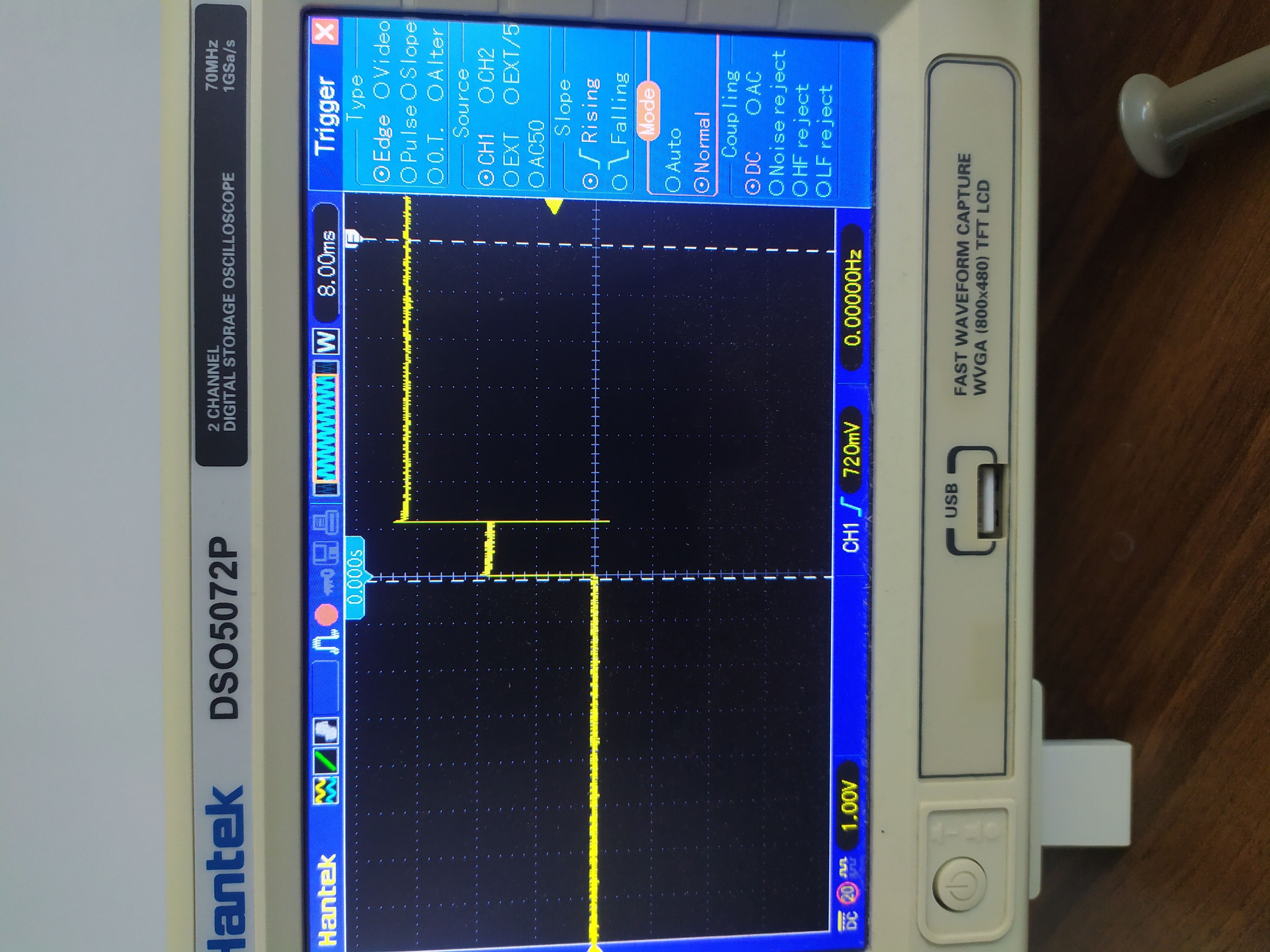

can someone help me to understand what is happening during the ESP32 start?
lets talk about the IO33
i wrote a simple code to set IO33 to output pin and set high level after start. but on the osciloscope I can see this: picture in attachment
I do not understand why the pin goes to 2V for 8ms and then is set to 3.3V
can anyone help me to understand what is happening here ?
or am I doing something in wrong way ?

My guess is that the pin is initialized to Hi-Z (floating) at power-on-reset. Then it takes some time for the CPU to start running your code and set the level high.
You could try adding an external pull-up resistor to 3.3V so it goes high when the pin is hi-Z / floating.

I have seen this behavior as well. I think phatpaul's explanation and suggested method of handling the pin are correct. I've used the pull-up successfully.
