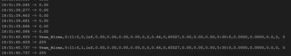

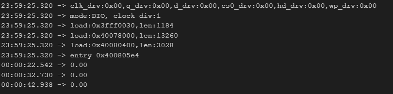

Issue: The code execution is very slow, the data is printed at random time in serial monitor. I haven't connected anything with the esp, still the same issue occurs.
I ran the same code on an RP2040 and it ran perfectly, no such delays. I also tested this code with 4-5 different esp and still the same issue occurs.

ESP32 (See the time difference between zeroes)

chegewara
Posts: 2505
Re: Esp32 Freezes
Postby chegewara » Tue Mar 19, 2024 4:32 pm
smartDelay(0);
static void smartDelay(unsigned long ms) {
  unsigned long start = millis();
  do {
    while (Serial2.available())
      gps.encode(Serial2.read());
  } while (millis() - start < ms); <---
I believe this loop never exits.
