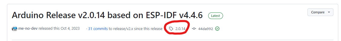

@lbernstone, interesting, thanks. In the meantime, I've found there is some past documentation (for v2.0.14 at least) on the GitHub, but it's format isn’t as nice as the web page I mentioned. To see it, go to https://github.com/espressif/arduino-esp32, then the page for Release v.2.0.14:
Screenshot 2024-03-28 135626.png (91.55 KiB) Viewed 5179 times
Then click:
Screenshot 2024-03-28 140204.png (22.53 KiB) Viewed 5179 times
The follow: docs --> source --> api

Espressif in docs is using "latest" word as for the master, not the latest stable version.
Github is using "latest" word as for the latest released version.

chegewara, the version can be changed using the drop-down:
