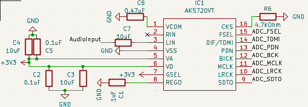

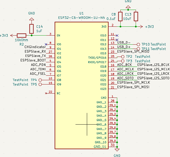

Hey all,
I'm back! The last time I posted here I had some problems with my audio codec AK5720VT, and the chip I was working with ESP32-C6 was crashing whenever I tried to use it. This was because of the size of the samples I was trying to allocate. Now I come with a different problem, in which I now receive massive amounts of data from the codec but nothing is being inputted into the codec. Even when the input for the codec is grounded, and even when I use a frequency generator to emulate audio.

My schematics:
Screenshot 2024-03-31 205113.png (12.92 KiB) Viewed 2604 times
Screenshot 2024-03-31 205101.png (27.15 KiB) Viewed 2604 times
I really appreciate any information people can give me!

Honestly, I'm not quite sure what you're question is actually about.
It sounds like you're asking about why you are receiving I2S samples from the ADC irrespective of its analog input signal. That one would be easily answered: The ADC will send a sample to the µC every time the µC requests one, i.e. for every 24 bit clocks the µC sends it will receive one sample from the ADC.
Or is your question about wrong/implausible sample values?
This may well have to do with the encoding/interpretation of the sample values. Specifically, values like -1515870811 are outside the possible range of a (singed) 24-bit value (i.e. +/- 2^23, or about +/- 8'000'000), so there's definitely some inconsistency there.
Edit: Looking at the chip's datasheet I found that it outputs its 24 bits 'left-aligned", so in fact it could also be the lowest 8 bits of a 32-bit value which are 0.
However, -1515870811 is 0xA5A5A5A5 which doesn't look too much like an actual ADC sample, and still is more than 24 bits.
(In the datasheet, 32-bit slots are used for the 24-bit data, so you may want to set up your I2S with I2S_SLOT_BIT_WIDTH_32BIT.)
