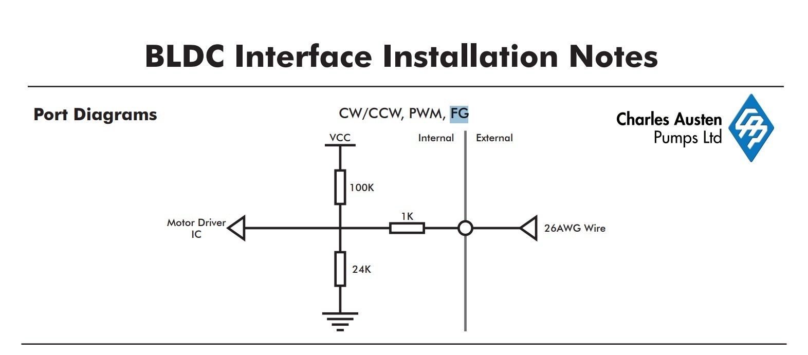

hi, i have a code used to control 4 pumps, and i use PWM to control their power (flow).
0V means 100% power.
5V means 0% power.
problem is that every time the ESP resets, the pumps starts to work for a brief moment, as if the output pin went low during that time.
i have seen Espressif's 'ESP32 pin list' document, but still not sure what to do, love to hear advices.
I'm using pins 12,13,14,26 pins as PWM outputs.
thanks.

hi and thanks for the reply,
i have already tried once to put a 100K pull up resistor and it didn't worked
the PWM output pin is connected to the pump VIA a buffer '74LS07DR'
also, in the attached figure from the pump data sheet we can see there is some kind of pull up resistor and yet its happening.
it might be something with my code?
the io's of the pump scheme from the manufacturer data sheet
lbernstone
Posts: 1138
Re: PWM output pin on reset
Postby lbernstone » Tue Apr 16, 2024 4:22 am
You need a stronger pullup than what is included in the pump control circuit there. Try a 10K.
From your description, this is happening when the device restarts, so it literally can't be a problem in your code (which isn't running during a restart). You say there's more involved in the circuit- I am not going to guess at your schematic. If you can see that the device starts and stops when you apply 0V/3V3, then what you need is a pullup resistor.
