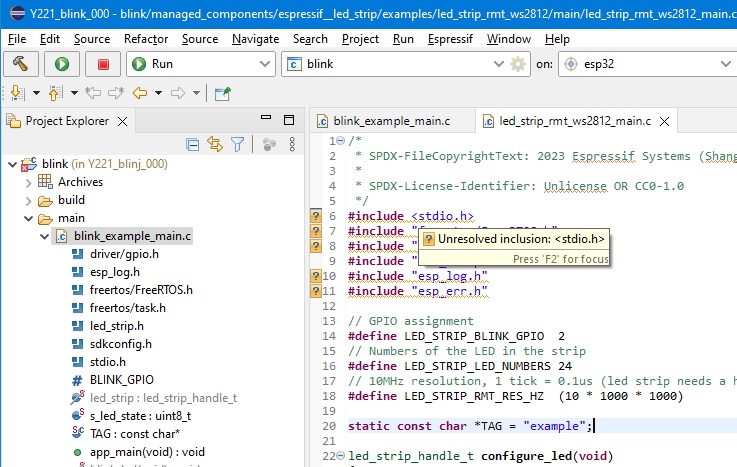

Additional... Eclipse shows that <stdio.h> is an unresolved inclusion. How the heck can stdio.h not be resolved??

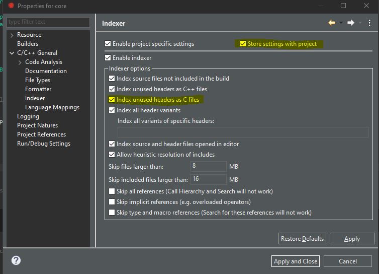

My unresolved inclusions got fixed by check marking the following: index unused headers as C files

After creating a new project from any demo project, compilation goes without errors.
Immediately after this, when entering to a C file for the first time (for example, in the file with the main() function), the errors appear.

Project
Properties
-> C/C++ General
Indexer: Configure Workspace Settings ...
Index source and header files opened in editor
