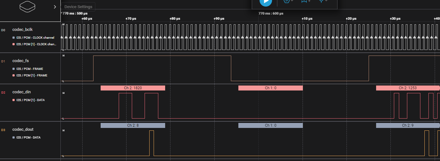

I'm using an ESP32-D0WD-V3 with esp-idf v5.1.2. I'm trying to communicate with a codec that is i2s master that is sending 64 bclks per wclk. The data is 16bits stereo and the sample rate is 16000hz. With the following configuration I am able to transmit data correctly but the read always times out. If I set data_bit_width=I2S_DATA_BIT_WIDTH_32BIT the reads are successful but this leads to incorrect tx data. I attached a logic analyzer trace showing the i2s transaction. What gives?

The first strange thing is that you have 64 pulses for only 2 channels of 16 bits. There should be 32 and not 64. So you have to adapt to that (what you have) by providing different setups for rx and tx.
But you passed the single variable to both functions which means if you change value in that single variable to match i.e. tx it will mess with rx and viceverse. So just try to make two different variables for testing and if it work you have to search for why you have 64 instead 32 pulses (if you want to go deeper to what causes problem). So try something like:

Sorry if my previous response sounded snippy, it wasn't intended that way. I wanted to say that I do very much appreciate your response. The separate configurations is at least a workaround. I can make it work that way, but it's a waste of RAM because my dma and application buffers will need to be double the size, and a waste of cpu because I'll have to manually extract the real data.
Now, while I agree it seems silly to have 64 bcks for 32bits of data, there should be nothing wrong with that from an i2s perspective, also I have an explanation for that. My codec allows me to select 32 or 64 bcks per wclk. When I use 32, the esp periodically (~ every 23ms) drops one 16 bit slot of transmit data, which is maddening. It's not a dma buffer problem as the drops do not occur on buffer boundaries. I have run the exact same code on the esp32-s3 and same codec without a problem. Moving to 64bclks/wclk seemed to work around that problem, I assumed maybe the i2s hardware fifo wasn't able to setup quickly enough to meet the timing?
Anyhow, this is the source of my frustration, I workaround one issue on the tx side and it makes an rx problem. It just seems to me that this is either a driver bug or a hardware bug on the esp32 and I'm hoping Espressif can offer an explanation.
