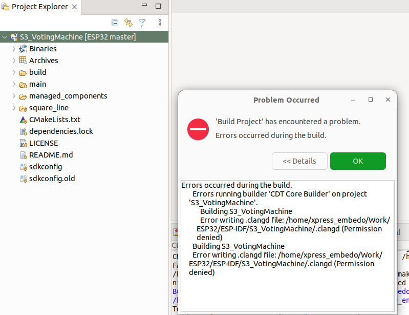

And when I tried to build the project EspressIf IDE, I have the following issue.

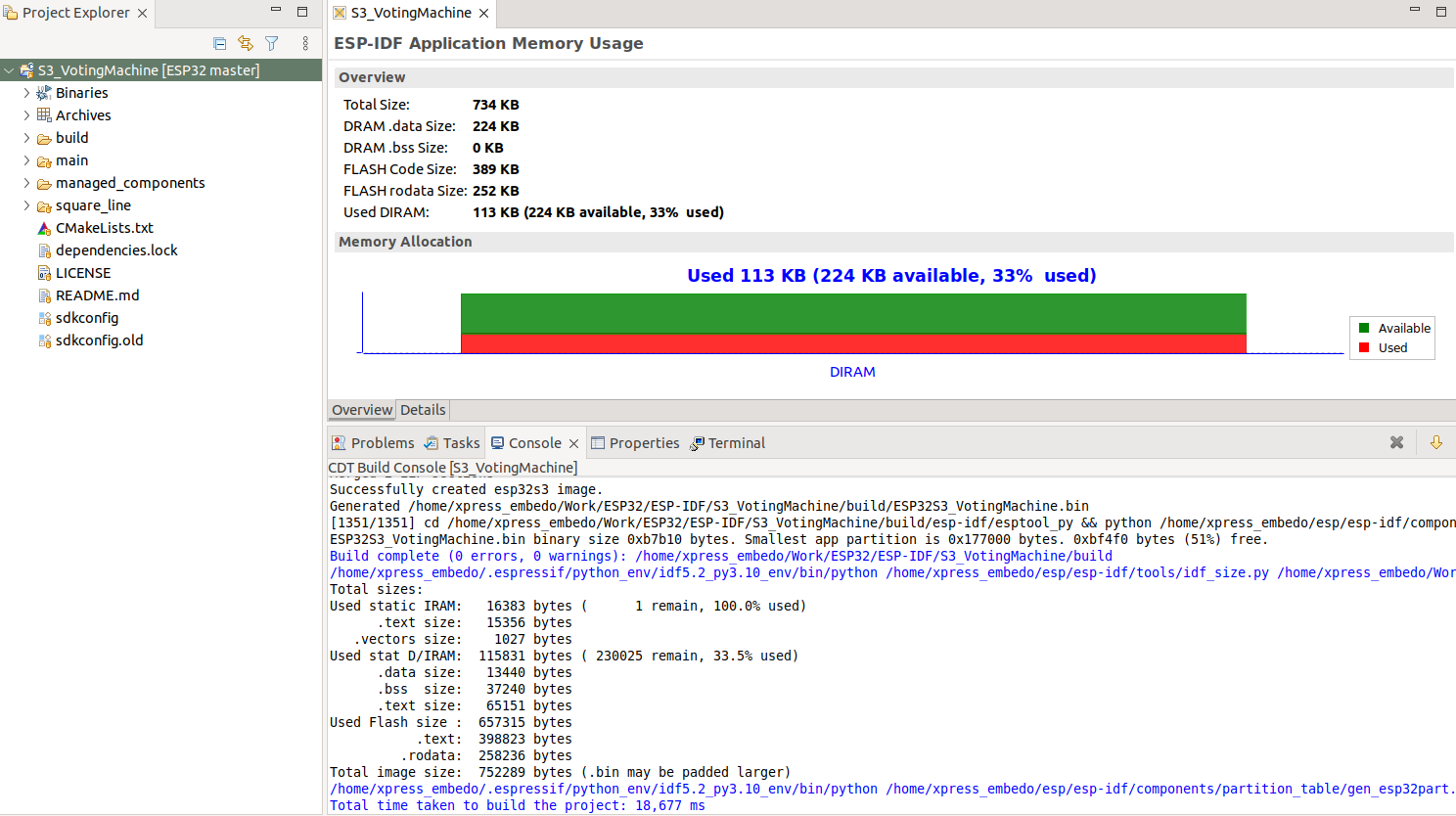

But when I run the EspressIf IDE with root privileges, it works fine.
It looks like some permission issue, but what exactly I am not able to understand.

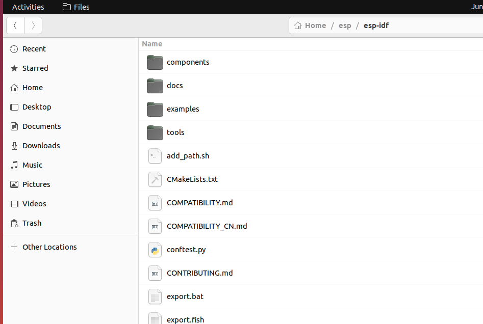

The ESP-IDF is installed here, which is inside user folder.
