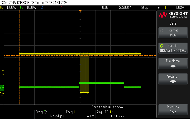

I am currently working with a PCBA that has a esp32s2 chip that uses a UART channel to control a VFD over a simple MODBUS interface. The module is set up to use UART serial that is connected to a RS485 Field Isolator with RX, TX, and TX_enable. When my module sends a packet, it sets TX_enable in order for the isolator to pass the signal, and drops it to receive the response.
I am seeing an issue where when the module transmits a UART packet, it will hold the TX_enable for high too long and I miss the response. In my test systems I have two identical PCBAs running identical firmware connected to identical VFDs and one will show this issue for less than 5% of transceive events, and the other will fail on over 25% of packet comms, so there could be some hardware issues as well.
In this trace we are monitoring the TX line out of the esp32 on the yellow channel and the TX_enable out of the esp32 on the green channel. You can see that the TX_enable line is getting held for ~6ms past the end of the TX packet - and unfortunately the VFD response is just 2ms after the packet and it gets clobbered in the Field Isolator because the TX_enable line is still high.

Most of the Message packets are properly bracketed by the TX_en (high while the packet is being sent), but I'm seeing upwards of 25% of the messages having the lagging TX_en.

SOLVED!
I started going over the API docs in detail and found this:
The ESP32 UART controllers themselves do not support half-duplex communication as they cannot provide automatic control of the RTS pin connected to the RE/DE input of RS485 bus driver. However, half-duplex communication can be achieved via software control of the RTS pin by the UART driver. This can be enabled by selecting the UART_MODE_RS485_HALF_DUPLEX mode when calling uart_set_mode().
Once the host starts writing data to the TX FIFO buffer, the UART driver automatically asserts the RTS pin (logic 1); once the last bit of the data has been transmitted, the driver de-asserts the RTS pin (logic 0).
To use this mode, the software would have to disable the hardware flow control function. This mode works with all the used circuits shown below.
I was already setting up the UART driver to do exactly this, but then I was controlling the TX_en pin as a GPIO on top of that:
    if(_tx_en) _tx_en->set(1);
    _uart_channel->_do_tx( _tx_buffer, _tx_len, 10 / portTICK_PERIOD_MS, true );
    if(_tx_en) _tx_en->set(0);
I disabled the _tx_en GPIO that gets set before and after the _do_tx which allowed the UART driver to control the RTS on its own.

So, lesson learned, if you use UART_MODE_RS485_HALF_DUPLEX, the UART driver will control the RTS on its own, don't try to control it yourself or you'll probably end up with races and collisions.
