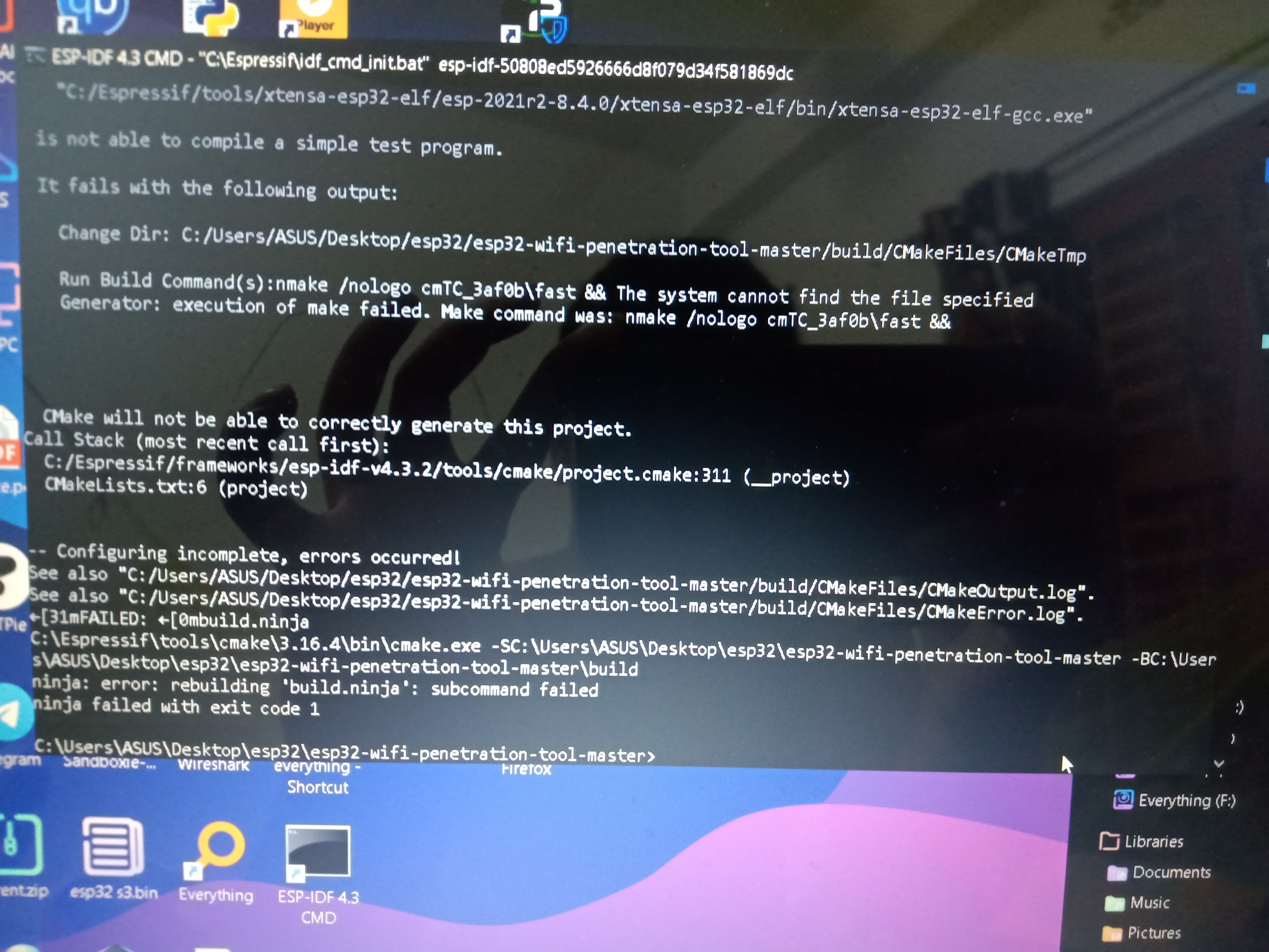

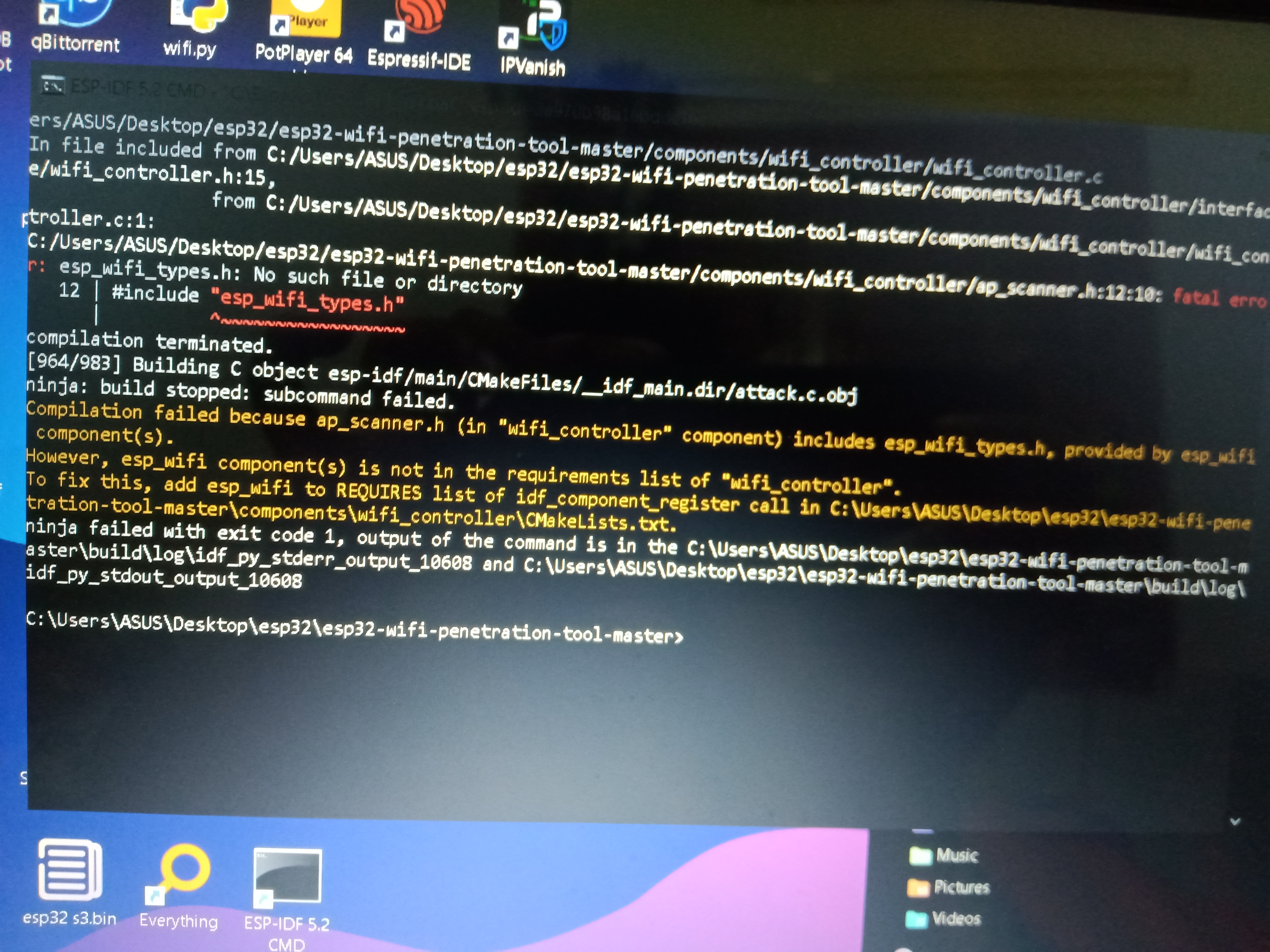

Esp idf component error
Postby wiwjwhw » Sun Jul 14, 2024 7:42 pm
No matter how i try add in cmake/dependency the error never goes. Added in photo. Sorry for dump question I'm noob. I'm building https://github.com/risinek/esp32-wifi-penetration-tool for esp32 s3

1. The code/project is already 3 years old. Chances are that it will need an IDF version which was current at that time:
This project is currently developed using ESP-IDF 4.1 (commit 5ef1b390026270503634ac3ec9f1ec2e364e23b2). It may be broken on newer version.
2. The code/project targets the ESP32, which differs in some ways from an ESP32-S3, and may or may not work on/compile for an S3 as-is.

I used specified esp idf again not working!! Help me.
