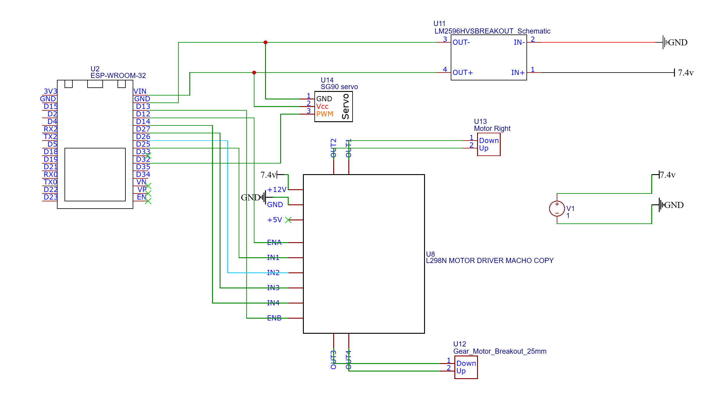

Background
I'm working on a robot car project using an ESP32 Devkit V1 (likely a generic dev board). We have 2 DC motors for moving the robot and a servo motor for a lifting mechanism.
I made a program to turn the servo motor (SG90 - non-continuous) to a given angle. The program worked fine. and the servo moved as expected.
I already had my main program made to make the robot move. This is done by giving PWM pulses to the ENA and ENB pin values of the L298n motor drivers, which change the DC motor speeds. This program works fine as well.
//L298N speed change
analogWrite(ENA, speedA);
analogWrite(ENB, speedB);
The problem
However, things changed when I tried to add the servo code to the main program. I'm moving the servo using <ESP32Servo.h> with the following code:

After some testing and experimentation, I realized that once the analogWrite() is called on any GPIO pin (in this case, pins for ENA and ENB), the servo.write() stops working indefinitely until the board resets. Consider this sample code.

For example, in the above code, the servo motor works once in the first iteration of the main loop (as analogWrite is called at the end). Then it reaches the analogWrite(ENA, speedA); and analogWrite(ENB, speedB);. After that, myServo.write(pos); doesn't work anymore. For instance, the servo doesn't move in any iteration after the initial iteration of the main loop.
Servo does move again and again indefinitely, as expected, without issues when I comment out the analogWrite(); lines.
Questions
  • What are the possible causes of this problem?
    How to make both the motor driver and the servo work at the same time. At least, what are the things I could try?
I attached the relevant components of my schematic
Schematic of relevant components
