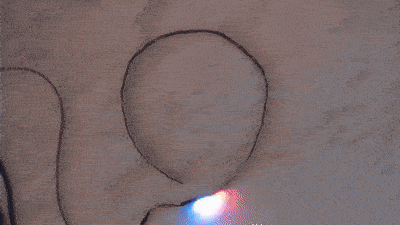

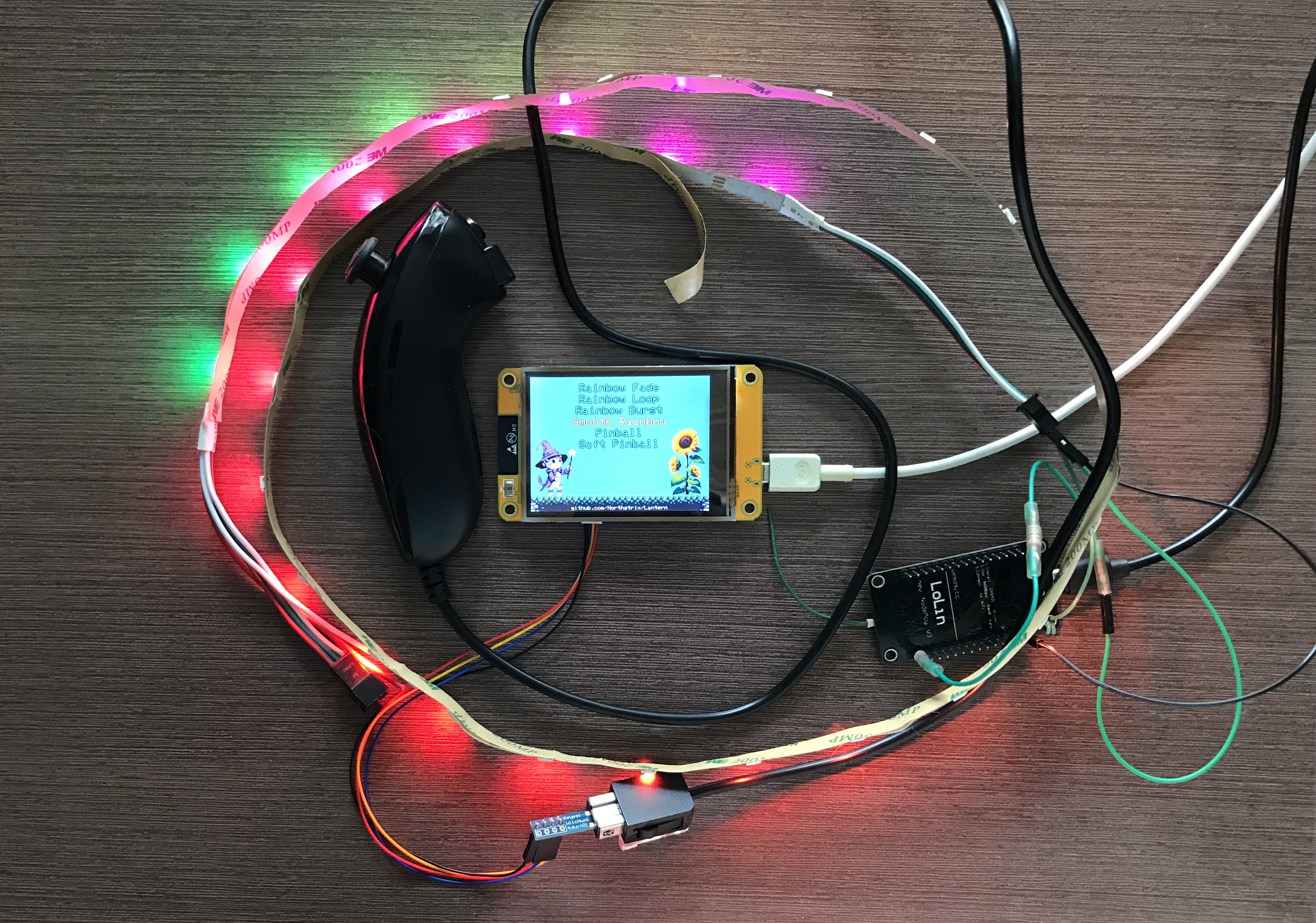

The Lantern project is an ESP-based addressable RGB LED strip controller.
It employs two ESPs: an ESP32 with a Nintendo Wii Nunchuk connected to it, which functions as a remote, and an ESP8266 connected to a WS2812 LED strip, which acts as the receiver and drives the strip.
The Lantern project offers 32 different modes and employs basic cryptographic features (that at least prevent separate transmitter-receiver pairs from interfering with one another).

P.S. I forgot to mention that this device has interface in two languages: English and Hebrew.
Additionally, the cat is animated!
