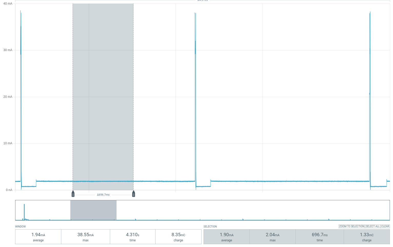

Hi, I'm looking into my custom board's light sleep current consumption. I'm expecting well below sub-1mA, given ESP32-S3 240 uA light sleep current (claimed on the datasheet) + quiescent current draw from components on-board which I estimate to just be a few hundred uA.

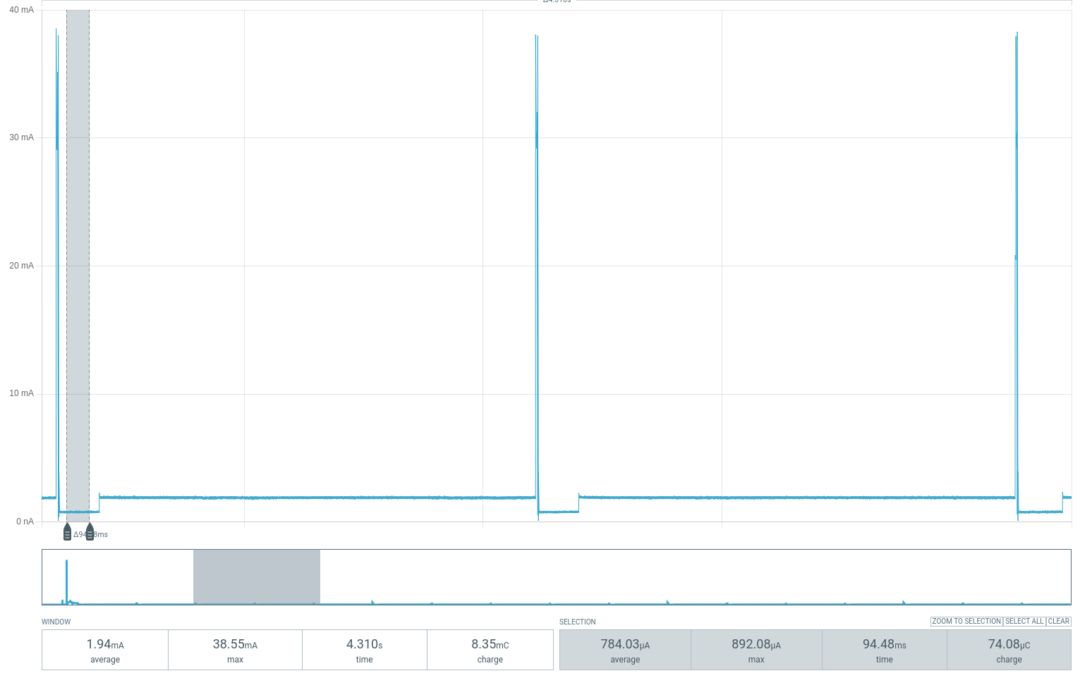

I've used the light sleep example to test it out, with the only modification to the example disabling the uart and touch wake. However, when I look at the current draw through a Nordic PPK2, I get this:
There is a ~700 uA dip for ~100 ms+ (which is what I expect light sleep current to be around), then the current consumption goes to ~1.90 mA. Is this normal?

Ok, this seems to be related to some current leakage to the flash. If flash *is* powered down, the light sleep current remains at ~700 uA.
Though, is the leakage current expected to be that high (difference of ~1.1 mA), even with the workaround Kconfig option enabled?

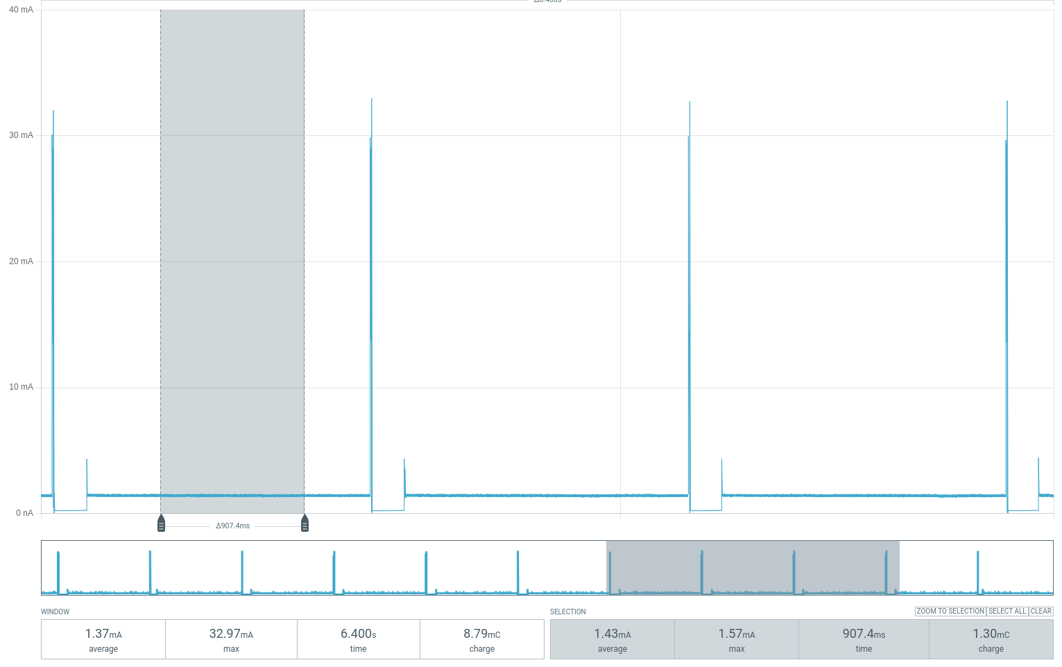

Another update, I think I've managed to reach the theoretical light sleep current mentioned in the datasheet:
This was achieved in the following conditions:
- kconfig: enable PM, enable tickless idle, enable flash power down
- configure pm with auto light sleep enabled
- use esp light sleep start function + timer wake *or* task delay
However, again: if the flash power down is disabled:
There is a dip to ~200 uA, and then it increases to ~1.4 mA. It would be nice if there is a way to not such have a high penalty for turning off flash power down...
