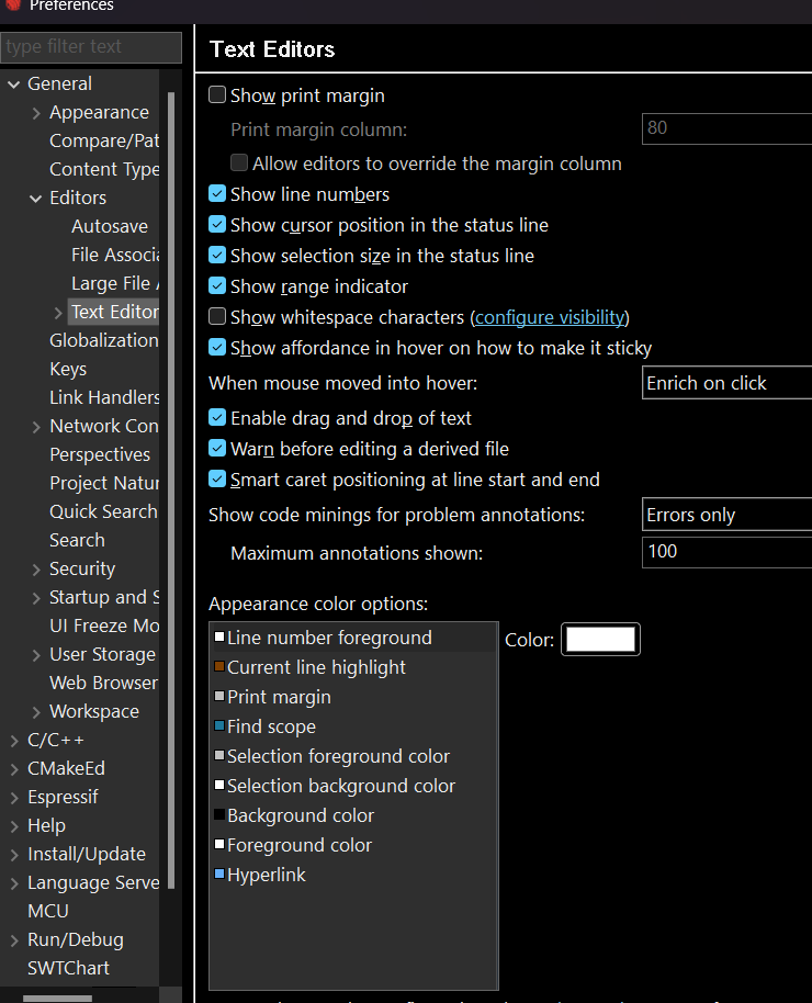

If you're talking about Espressif-IDE 3.0, please check the preference window for Preferences > General > Editors > Text Editors
Thanks
Thanks
Re: The color palette

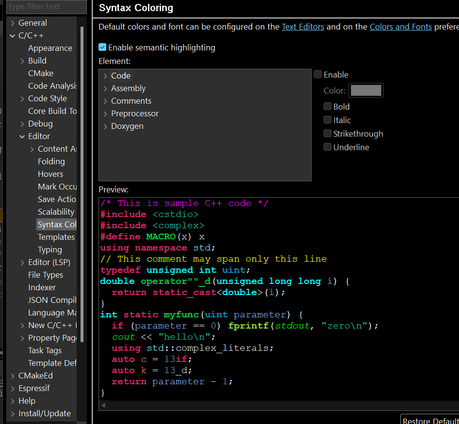

Maybe I put it wrong. We are talking about the color display of lines of code.
- Снимок экрана 2024-07-10 144453.png (93.55 KiB) Viewed 18055 times
I've tried it. Some values change, but most do not.Hello,
Thanks
- Снимок экрана 2024-07-10 144835.png (75.1 KiB) Viewed 18050 times

I was also trying to change the color palette due to I am unable to code with the default... that soft colors are so difficult to see...
I realised the problem is that, by default, files are opened with a new text editor "C/C++ Editor (LSP)" which I think is not configurable...
Solution: Right click on a .c file -> Open with -> Other... -> C/C++ Editor (NOT the LSP)
The color palette will be the original and fully customizable on preferences menu.

I too would like to second this problem. I would like to use 3.0 but the lack of syntax coloring options is a problem. According to: https://developer.espressif.com/blog/es ... p-support/
"The LSP C/C++ Editor is derived from the standard Eclipse Text Editor, so you can change the editor color options from the Text Editor preferences"
Would it be possible to derive the LSP C/C++ Editor from the standard eclipse C/C++ editor instead? Then we could have our syntax color options back.
A further problem I noticed is that in 3.0 I'm unable to open C files with the C/C++ editor by default. I do right click->open with->other and then I select C/C++ Editor and select the checkbox for "Use it for all *.c files* but the option never sticks.
