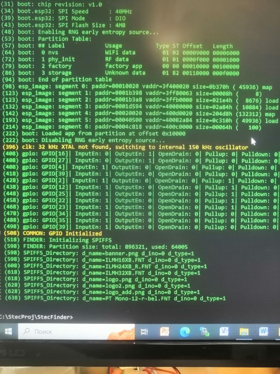

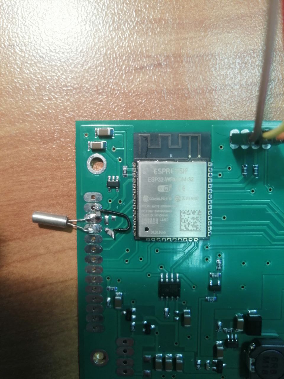

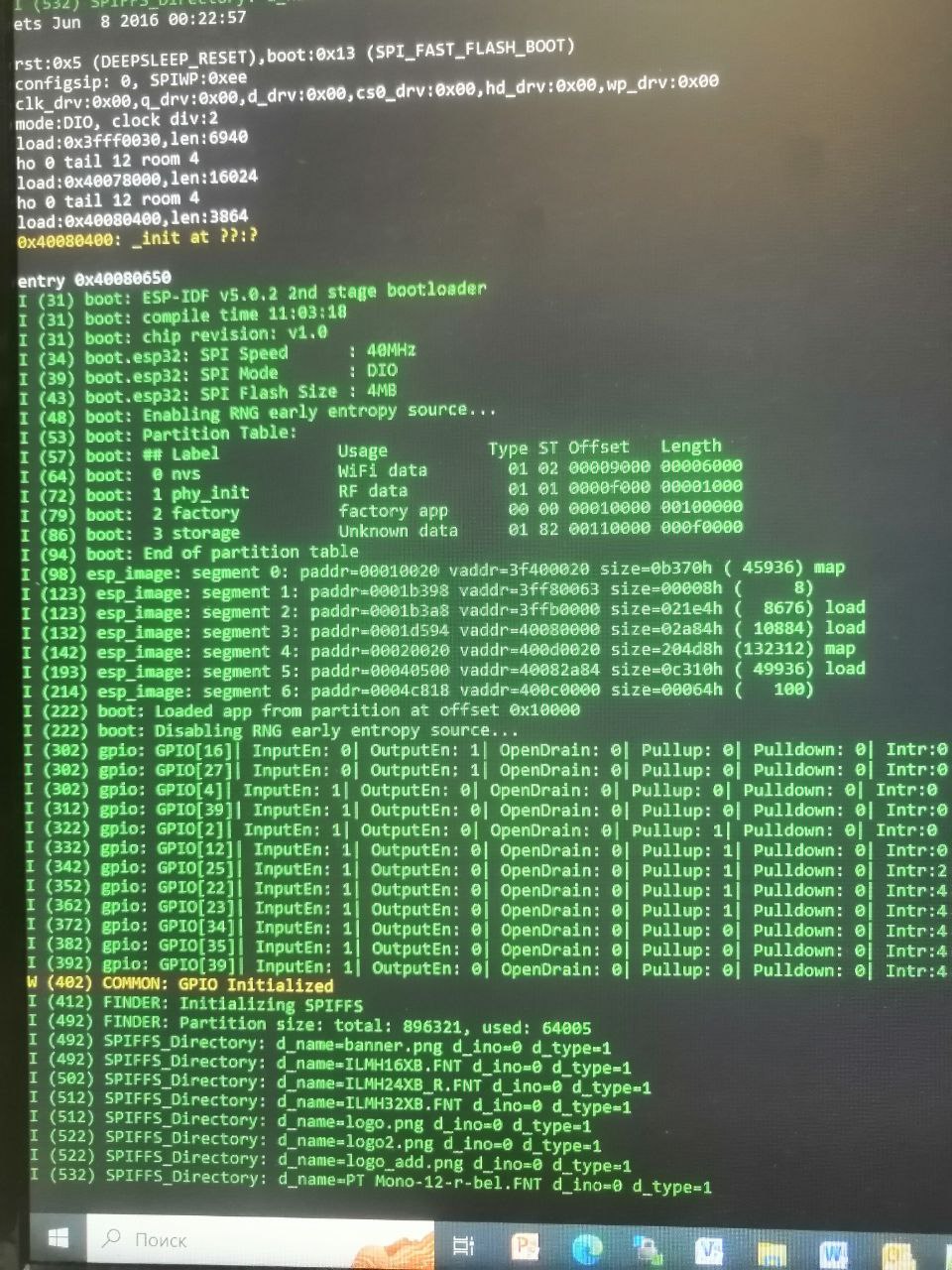

UPD. I found old our device with ESP32-WROOM-32 (ESP32 chip's revision 1.0 ESP32-D0WDQ6) and add the cheapest 32768Hz crystal with two 22pf. Specifically soldered them all in violation of the requirements to check work, set using external 32kHz in menuconfig.
Code initializes GPIO of ESP32 and after that goes to deep sleep (ULP disable) for 10 sec. After DEEPSLEEP_RESET as you can see everything works. Exactly 10 sec.
If I touch crystal's pins by my finger, the oscillaction fails and the WROOM switch to internal oscillator.
Also I freeezed the board with the RTC crystal to under zero temp and it also works well.
So , I cannot undestarnd is any issue or not. Today I couldnot get it.
Could You share Your code and details about the settings that I can repeat the process? I've a real issue with running the RTC with external crystal even using the 12.5pF crystal, 2x22pF caps and 10M parallel resistor together with esp32-wroom-32e.
