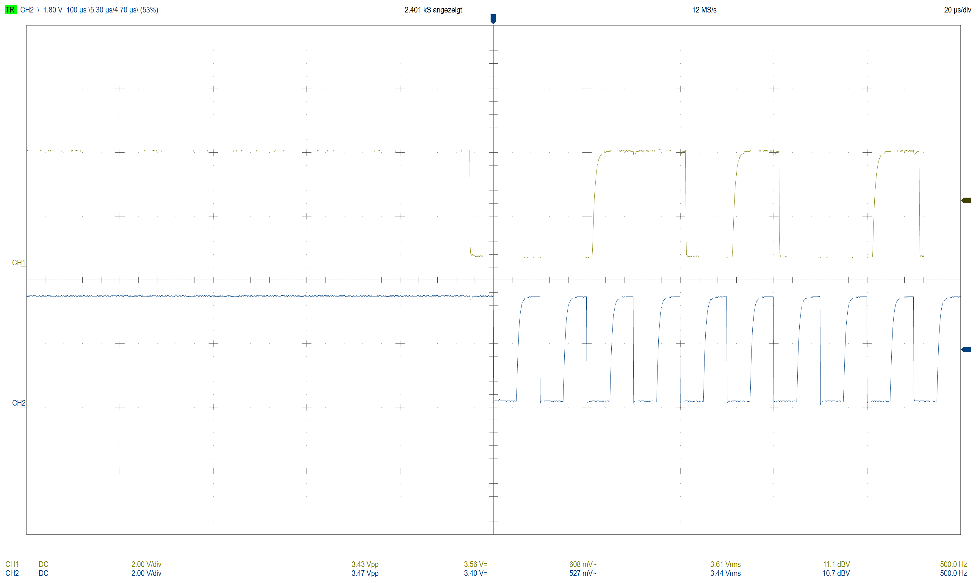

I am unable to communicate with the NAU88C22 audio codec using I2C on the ESP32s3 under IDF 5.3. Here is the setup: I have a custom-designed PCB with an I2C bus. The ESP32s3 is configured as the I2C master, and there are several I2C slaves on the bus, including an AHT20, an LSM6DS3, an NAU88C22 codec, and an STM32G431. The STM32G431 usually operates as an I2C slave.
Communication with the AHT20, LSM6DS3, and STM32G431 works without any issues using the ESP32s3. However, I am unable to reach the NAU88C22 codec.
However, when I reconfigure the STM32G431 to act as an I2C master and disable the ESP32s3, the NAU88C22 codec is accessible. To further diagnose the issue, I captured the communication with my oscilloscope. I noticed that the SDA line consistently lags behind the SCL line by about 1 microsecond. In contrast, with the STM32G431 as the master, the SCL and SDA lines are perfectly synchronized.
Could this be the cause of the communication issues? How can it be resolved?

Attachment: oscilloscope hardcopy, top=SDA, bottom=SCL, measument= delay of SDA with respect to SCL, ca. 1us
Regards, Klaus

Could be your glitch_ignore_cnt setting; iirc the ESP32 reads SCK to see if it indeed changed before it moves on, and glitch filtering may delay that.
Note that this actually is valid I2C: according to the specs, SDA can change whenever SCL is low, so this shouldn't cause the NAU88C22 to not be recognized. (Additionally, a project of mine is driving a closely-related NAY88c10 with the same glitch filtering settings and it works perfectly fine.)

I changed the glitch_count to 0 and to 1, but this does neither affect the waveform nor the accessibility of NAU88C22.
Hmm, well, yes: According to the spec, the behaviour of the ESP32s3 is perfectly fine. But this lag is the only visible difference between the (working) STM32 and the (non-working) ESP32 waveform.
Its frustrating...
What am I missing? Has anybody any further advice?

Agree that this is weird. Thinking outside of the box: are there any other lines influenced by one of the two MCUs that can influence how the codec works? E.g. CSB/GPIO1 or MODE?
