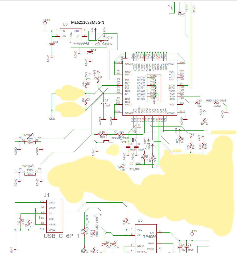

What's the deal with GPIO2 ? Sorry I didnt know there was a GPIO2 requirement as well.
Here is the schematic - at least the parts that I can show. Nothing weird about the circuit. I can try again to look for ripple on the Vcc line but it looked amazingly clean and teh voltmeter didnt flinch when I hit reset. not even a movement by .1 volt.
The LiPo is 1000 mAh and I've used this LiPo on other ESP32C3 circuits and it worked perfectly.
I agree the 6 mA is suspicious

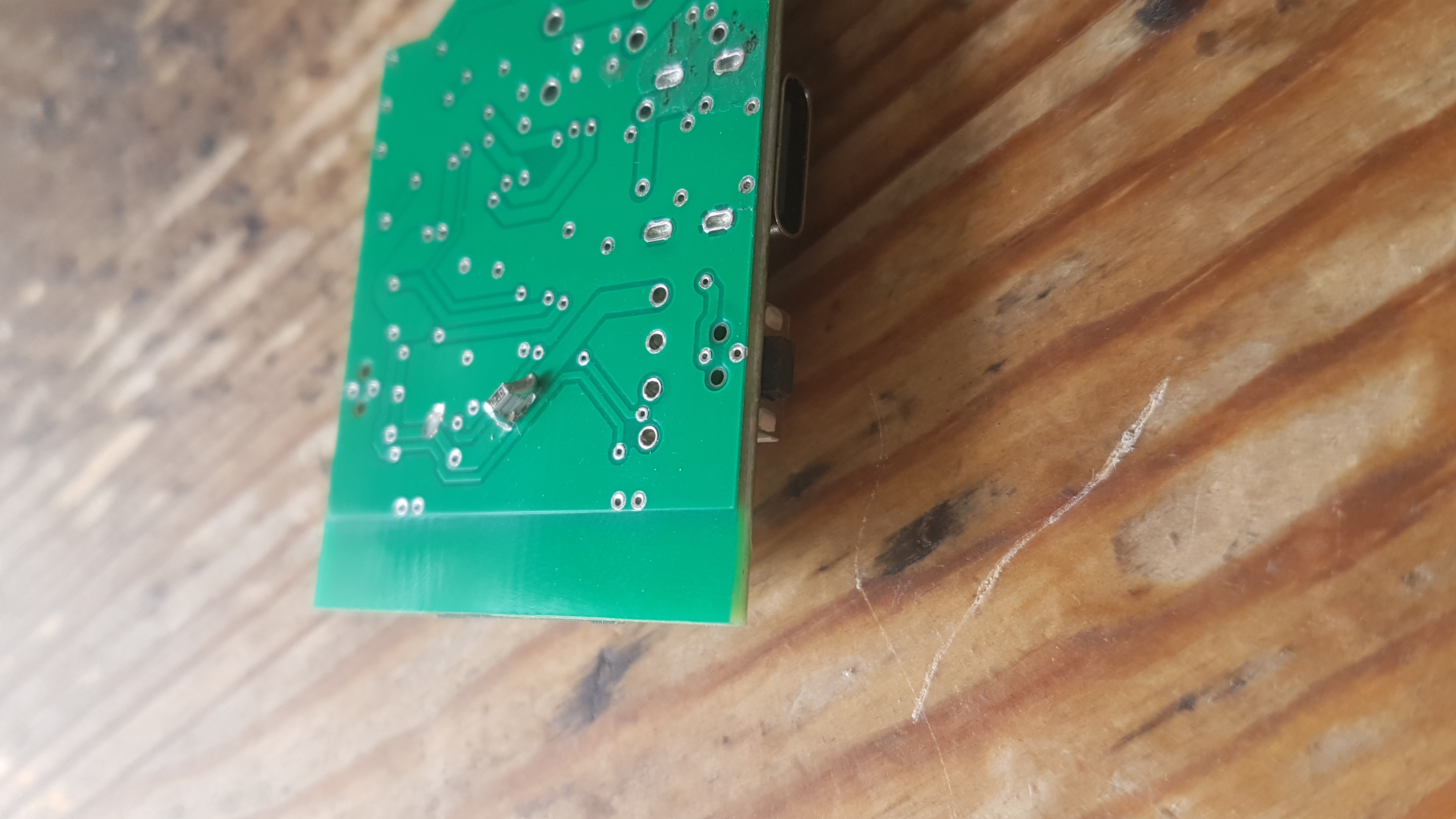

Alright so I took a dremmel tool and obliterated one line going to GPIO2 just in case it was pulling it down in voltage at all, since the technical reference manual also specifies that GPIO2 must be high for any kind of boot. Did that. Checked with the voltmeter. Perfect 3.3v on GPIO2, 3.3V on GPIO8, and 0v on GPIO9.
Still the same problem 6mA
