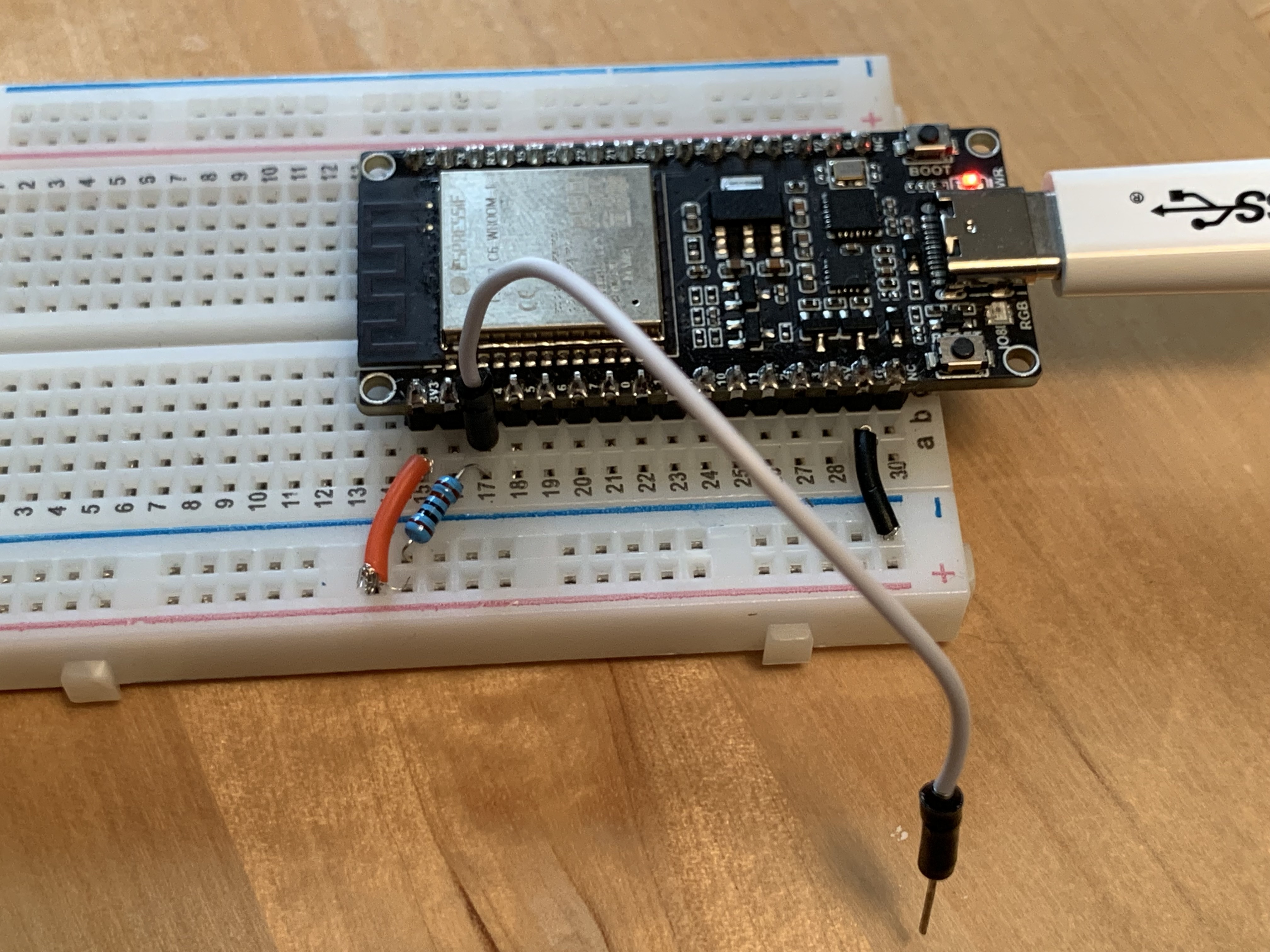

I've a lot of experience with programming and computers, but I'm pretty new to microcontrollers and making electronics.
For a PIR project (substituting my current alarm's PIR's controller with new ones as the current controllers aren't supported any more), I've a little prototype with an ESP32-C6-WROOM-1 dev board connected on a breadboard in the following way:
- 3v pin to +
- GRD pin to -
- pin 4 pulled down with resistor to -
- a floating wire connected to pin 4 for testing
This is the behavior I need:
- ESP32 is turned on
- ESP32 goes to sleep
- pin 4 goes to high (testing wire touching +)
- ESP32 wakes up (cause: external signal)
- pirInterrupt() is called
- "Motion detected!" is printed
To achieve this I wrote the following code:

When I touch + with the testing wire I get this:
ESP-ROM:esp32c6-20220919
Build:Sep 19 2022
rst:0x5 (SLEEP_WAKEUP),boot:0xc (SPI_FAST_FLASH_BOOT)
SPIWP:0xee
mode:DIO, clock div:2
load:0x4086c410,len:0xc24
load:0x4086e610,len:0x2708
load:0x40875728,len:0x594
entry 0x4086c410
Wakeup caused by timer
Setup completed.
Entering deep sleep mode...
As you can see
- the wakeup is caused by "Timer"
- pirInterrupt() is not called
- "Motion detected!" is not printed
While debugging I noticed that if I quickly touch the + rail multiple times pirInterrupt() is called and "Motion detected!" is printed, I have one only possible explanation for this: Wakeup "consumes" the signal so the interrupt needs a new signal to work.
My questions are:
1) Why is the wake-up caused by "Timer"? I was expecting one of the 2 "Wakeup caused by external signal using [...]", what am I doing wrong? (I will need to do different things depending on the wakeup cause)
2) What's the best way to solve the signal issue? Since I cannot control the signal's producer, I thought I could put a small capacitor in to "buffer" the signal and perhaps allow it to be "consumed" twice, but I'm afraid the cap might also add a "debounce" effect and possibly mask series of signals or cause other bugs further into the project.
some esp dev guy
Joined: Wed Aug 21, 2024 12:08 pm
Re: ESP32-C6 deep_sleep and external wakeup + interrupt
Postby some esp dev guy » Wed Aug 21, 2024 12:19 pm
the esp_sleep_enable_ext1_wakeup function takes pin mask not the pin no as argument so value 4 corresponds to pin no 2 (2^2). Triggering the event by multiple touching could be caused by accidentally touching the neighbouring pins.
