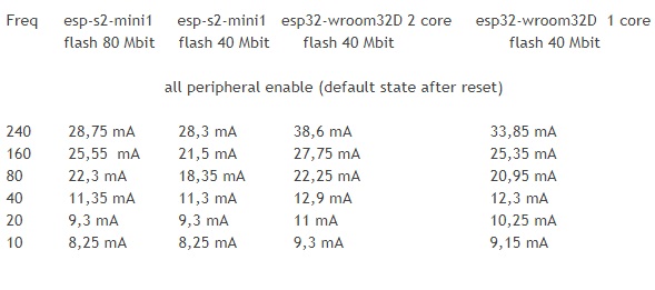

Hi There
I have to do a low power project (cpu always running, don't care sleep) with 15 GPIO and I want to keep using ESP as I love these chips and I am familiar with them. the project it's currently working on a esp32-WROOM-32E @ 10 Mhz , drawing (just the wroom module) ~13mA while running the code . I was expecting something lower but not sure if this test board as is very very old may be somewhat less efficient than the latest revisions.
Ideally looking for a drop-in replacement but I can deal if need to rewire some gpios or the frootpint.
From what I have learned it seems that I have 3 candidates
ESP32-S2
LX7 that it's rated as more enficient than LX6 and also 1 unique core so I presume I will necessarily get better consumption.
ESP32-C2
Seems to be a very low power option, but unfortunately there are not enough GPIOs.
ESP32-H2
It seems to be the lowest power option of all, but as it is a very new chip, there is hardly any information, examples, (arduino is only in beta phase yet) and in general, I find it very risky to trust a chip so early on.
If anyone has any further recommendations I would be very grateful, as well as sharing consumption while the CPU is working, my intention is to underclock as much as possible and there is no intention of using WIFI/BLE at any time.

ESP32-S2 is the most suitable candidate considering your need for 15 GPIOs and lower power consumption.
Yeah, Just looking I found this post where it seems that it is not worth using one module over another for consumption reasons, there is very little to none difference at low speeds
