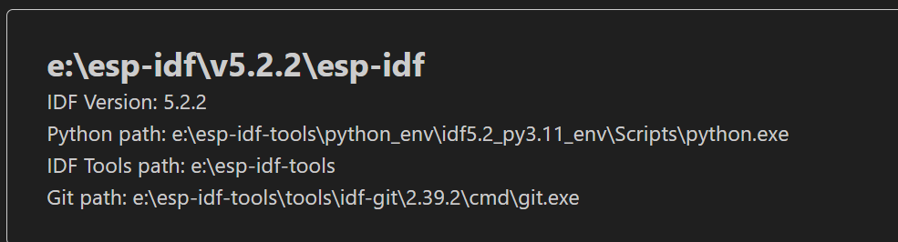

hello everyone , i have follow before recommands to install c/c++ extensions and build the project,the include problem have been sloved successfully,however i face another cmake warning .
in c_cpp_properties.json :
Cannot find "${env:IDF_PATH}/components/"
and cmake error in CMakeList.txts:
"resource": "/E:/esp32/esp32-c3-jlc/project/humi_temp/CMakeLists.txt",
"owner": "cmake-configure-diags",
"severity": 8,
"message": "CMake Error at CMakeLists.txt:7 (include):include could not find requested file:\n\n /tools/cmake/project.cmake",
"source": "CMake (include)",
"startLineNumber": 7,
"startColumn": 1,
"endLineNumber": 7,
"endColumn": 10000
blow is my c_cpp_properties.json:
"configurations": [
"name": "ESP-IDF",
"compilerPath": "${config:idf.toolsPathWin}\\tools\\riscv32-esp-elf\\esp-13.2.0_20230928\\riscv32-esp-elf\\bin\\riscv32-esp-elf-gcc.exe",
"compileCommands": "${config:idf.buildPath}/compile_commands.json",
"includePath": [
"${config:idf.espIdfPath}/components/**",
"${config:idf.espIdfPathWin}/components/**",
"${workspaceFolder}/**"
"browse": {
"path": [
"${config:idf.espIdfPath}/components",
"${config:idf.espIdfPathWin}/components",
"${workspaceFolder}"
"limitSymbolsToIncludedHeaders": true
"version": 4
CMakeLists.txt:
# For more information about build system see
# https://docs.espressif.com/projects/esp ... ystem.html
# The following five lines of boilerplate have to be in your project's
# CMakeLists in this exact order for cmake to work correctly
cmake_minimum_required(VERSION 3.16)
include($ENV{IDF_PATH}/tools/cmake/project.cmake)
project(humi_temp)
attach is my extension version info:
my c/c++ extension version:v1.21.6
"severity": 8,
"startColumn": 1,
"endLineNumber": 7,
"endColumn": 10000
"configurations": [
"name": "ESP-IDF",
"includePath": [
"browse": {
"path": [
"version": 4
CMakeLists.txt:
project(humi_temp)
