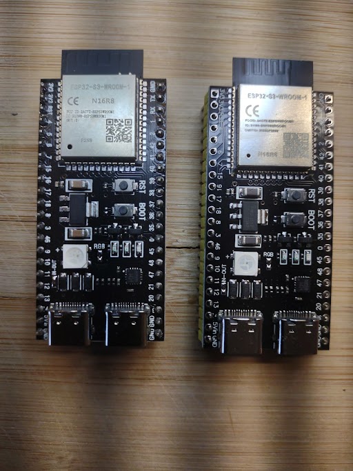

I use generic ESP32-S3-DevKitC boards as a sub-assembly in a product. These boards have an ESP32-S3-WROOM-1 module on them. I source them from a number of suppliers.
On some of these boards the WIFI doesn't work properly. It successfully scans for Access Points, but won't connect to an Access Point. In the following photo, the board on the left doesn't work. The board on the right works.
I found an earlier topic that describes a problem with being able to scan for Access Points but not connect:
viewtopic.php?t=32109
This earlier topic suggests touching the WIFI antenna with a finger while connecting. This works with my problem boards as well.
Looking at my boards carefully, I see a pattern. The boards that don't work have different markings on the ESP32-S3-WROOM-1 module than those that do work. In particular, the CMIIT ID is empty on the boards that don't work.
Also the onboard antenna on the non-working board on the left looks like a typical Meandered Inverted F Antenna (MIFA) while the antenna on the working board on the right has an extra meander.

  • Is there a way to configure the WIFI or PHY to work around this problem?
On some -C3 "Supermini" boards I found that I had to actually reduce the WiFi TX power from the default (20dBm?) (used esp_wifi_set_max_tx_power()) to be able to connect to a network. Probably due to a "sub-optimal" matching network and/or antenna on the board. IIRC, I could only go up to 11 or 13dBm before connection issues appeared. May be worth trying out.
tonystuart
Posts: 7
Joined: Wed Mar 25, 2020 10:59 pm
Re: WIFI Issues with ESP32-S3-WROOM-1 modules that don't have a CMIIT ID
Postby tonystuart » Thu Sep 19, 2024 12:16 am
Thanks... I'll give that a try.
Update: I tried reducing the max tx power and it connects. Very interesting... and a bit counterintuitive (at least for me)!

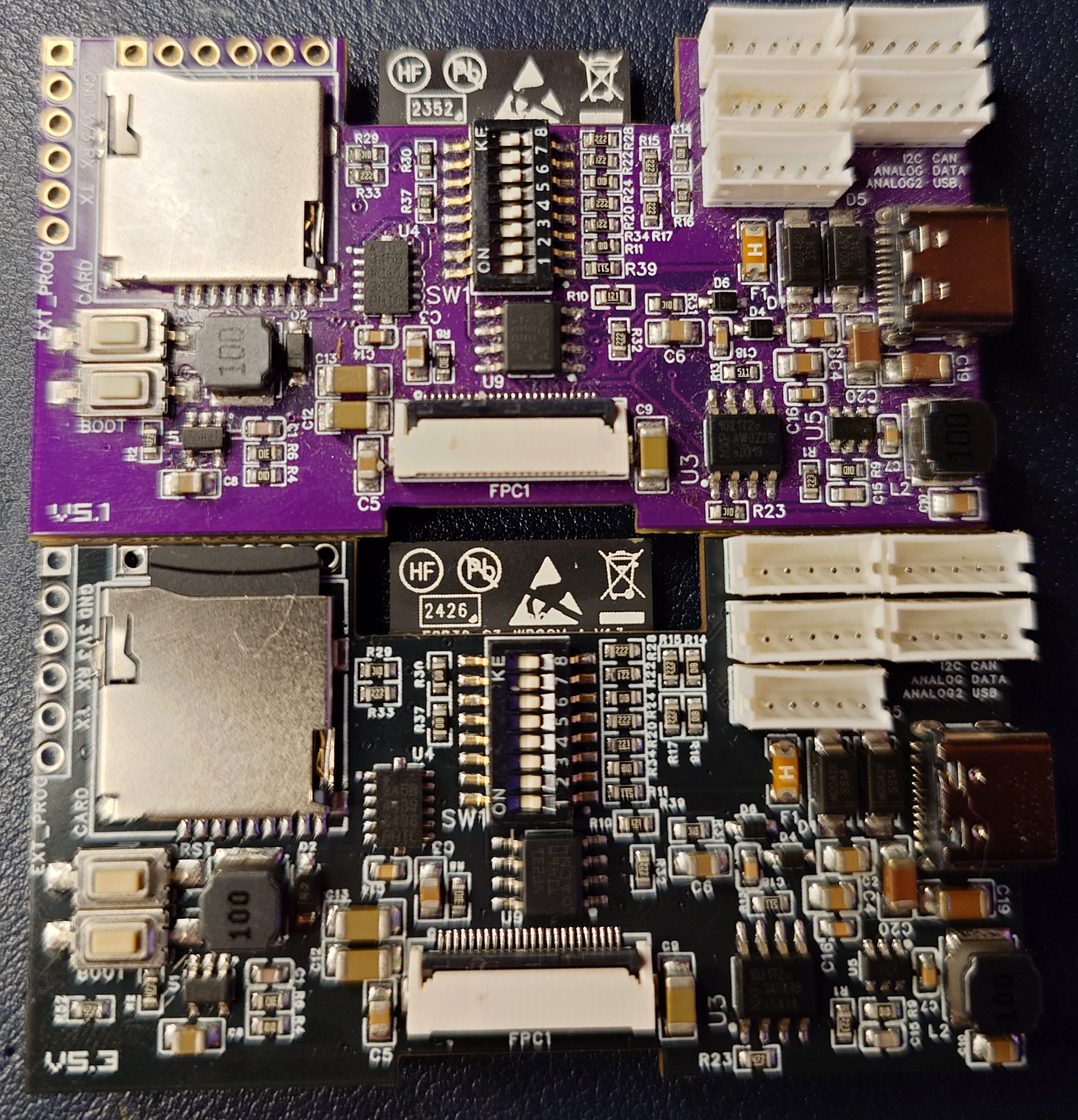

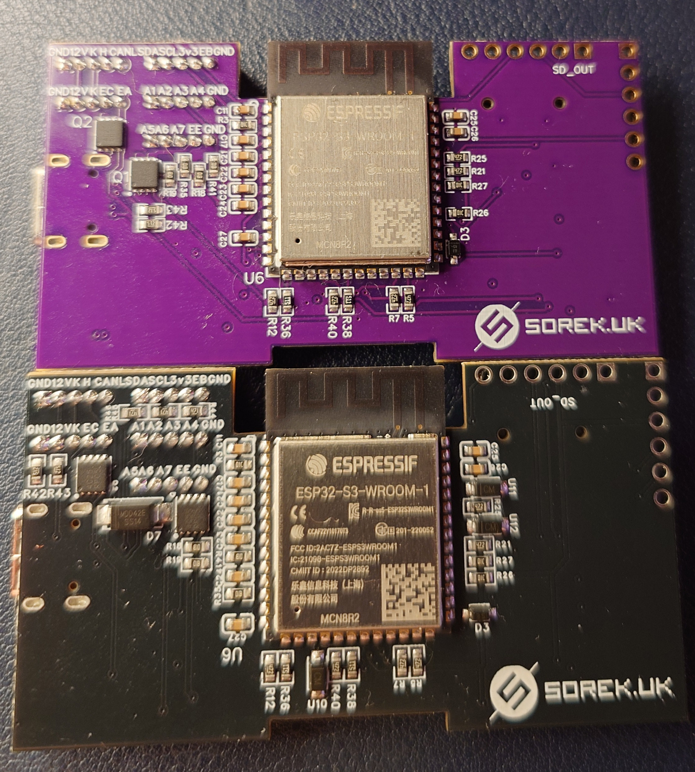

I am a bit mad at this because I ordered quite big chunk of ESP32-S3 and it's first time I have such problem with ESP32 ever..
For me using `esp_wifi_set_max_tx_power(40)` (or lower) doesn't solve anything, I basically have to have access point created on my phone next to the device and it connects once every 8 times which is bad (setting lower power doesn't solve that really).
Connection to home wifi is impossible while old board (violet) has no issues and does that usually within 500 ms (I have timout that waits for connection after .begin() and then fallsback to access point).
AP works good, and once device is connected to STA (or AP) it can maintain fast and stable connection even across two rooms - but still I have no clue what is happening there.
I noticed my ESP module only differs in single number of back of antenna, other than that (hard to show on pictures) faulty modules seems to have much worse etching on the front.
Not sure what to do at the moment as anything I try to do doesn't seem to work and wifi scan of network shows the same powers on both boards (within 2-3 db error).
